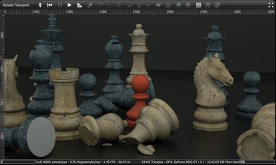

screenshot

Thank you man. It was because i have russian language folder. I just copy scene files in to disc D:\ and this work. I am very happy :D .
