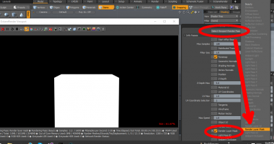

Hi
1) Enable the Info Passes->Render Layer Mask box.
2) Click "Select Viewport Render Pass" and select "Render Layer Mask".
Paul

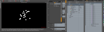

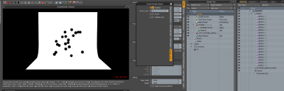

So to get what I was after I had to use layer id's on the mesh items I needed masked separately.
A simple example is an array of spheres hovering over a sweep. Without using layer id's I would only ever be able to render out the scene's alpha and in effect, this would mean seeing an alpha of the solid cove. I wanted to render out an alpha for the spheres as well as just the sweep/cove. In order to do this I assigned a layer id of 2 to the spheres and 1 to the cove.
Now... ideally I'd rather be assigning Octane layer id's to material masks and not individual mesh items. The option to do either / or would be great. It's probably not possible.
