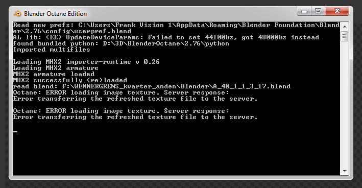

I was thinking it was early christmas. My euforia unfortunately took a dive when getting same error message regarding textures and server at my first render test. Path tracing seems to be more sensitive than Direct light for some reason. Direct light can give me one or two renders before I have to restart blender and hope for some more. If I´m lucky, preview rendering can work for a while longer than final render. Those times a Path trace render have actually started, 80% of the times it crashes both Blender and Windows. That has never happened with direct lighting if that can be a clue.
For a longer explanation please see last octane blender versions thread.
I thought "Fixed a bug: a modified image textures file re-uploading to the server failed" could have fixed this issue. Was it ment to? If not, I would love to get some help trouble shooting this.
Can it be a windows error? I´m on windows 7, 64bit, 2xTitan (V1). I thought I just push through two more projects before upgrading to Win10. In other projects than this I had no problem with rendering, but I frequently get blue screens when shutting down Blender. If this can be related to my issue above I will take the time to install Windows even if it will take quite some time to get everything in to working order. On the other hand, if it fixes the problem it is easily worth the time.
My last trick apart from upgrading to Win10 would be to go in to each separate product scene that contains imported fbx models, get rid of all textures but those I load in to octane nodes and then rebuild all my assembly scenes. The strange thing is that all separate product scenes, that I later append in to the assembly scenes, renders without any issues with those unused texture nodes present. So if I do this extremely time consuming effort, I can´t be sure it actually helps...

Looks like your problem is not related to the one that was fixed in this version.
I can't reproduce it on my scenes. You can just PM me the link to it - if I will be able to reproduce it on your scene, I'll release the fix quickly.

OK, I've downloaded your scene. There are no image files packed into the scene, so there is not much use of it to understand the reason of your problems.
But there are absolutely no problems if I set some image files manually into some of your image textures - these image textures are uploaded to server and rendered absolutely correctly, without any errors in the console.
So, the problem is somewhere on your side. Play with your image files and paths to them. Make sure all your image textures have the valid paths to image files. Make sure the texture files modification timestamp is set correctly by your system in the filesystem for both OctaneServer textures cache directory (c:\Users\<user name>\livedb\<machine address>\textures\) and source Blender scene image files.

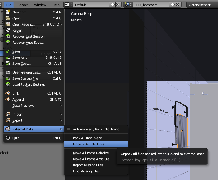

Thanks for checking it out. I wrote you that I failed to pack the files in to the Blend and you got a screen shot of the list of missing textures. What I can´t understand is why most of the missing texture links in that list were pointing to directories where the textures actually are. Is this where the time stamp could be an issue?
The way I have checked out if the image textures have a valid image path is to re open the texture in the octane texture nodes, making sure there are no strange characters in the search path or the file names. Is there a better way to do this?
I´m sorry, could you please clarify the time stamp a bit? What am I looking for and where exactly? One thing I notice when going to the folder c:\Users\<user name>\livedb\<machine address>\textures\ is that none of the textures in this problem project are present. Second, I noticed my user name have two spaces in it. When working I always avoid this and frequently use under score instead. But when installing windows I obviously did not think about the user name actually being part of a search path for Octane textures... Would you say this could be the problem? If so, why have it not been a problem before? I have worked for two years with Blender on this particular windows installation with no texture issues.
