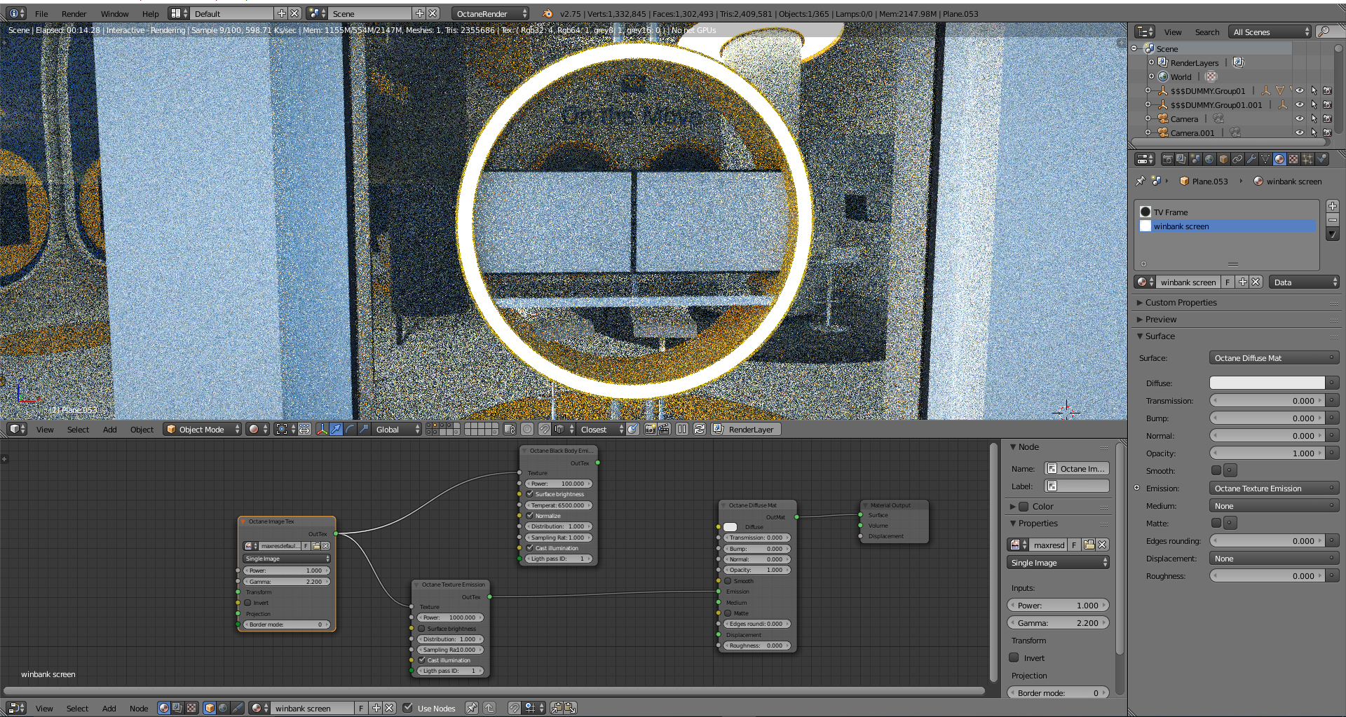

Hello,
I am trying to make a TV screen and I cant make it cast light with texture.
What am I doing wrong? It is propeely UV unwrapped, tested on diffuse input.

I have to ask some general questions first. Are the screens unwrapped and their normals pointing outwards? The other thing that might be wrong is I noticed that you have set the power of the emission really high (1000). This will wash out the image and make it white. Here is a quick test I did:
Here I have set the power of the emission to 80, and I set the power of the texture to 0.5. Hope this helps. :)

Hello Jason,
It was the normals direction!
Thank you for your quick help!!
