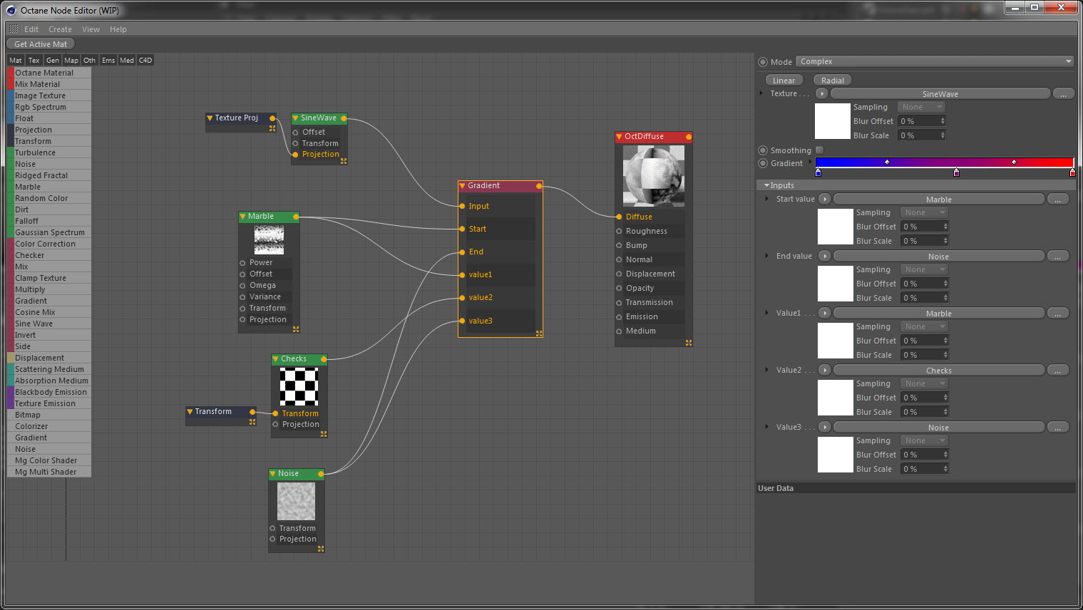

I'm trying to rebuild the MBB quixel PBR node in c4d, and there comes a problem when switch gradient node to complex mode, I can't make start value driven by any nodes I try(FloatTexture or MixTexture), but it can be done in standalone, anyone knows the reason? thanks.

It's always better to post some images like this. Otherwise just more confusion happens.

thanks for the reply, it's my mistake on connect some node, and I use another way to do that, thanks!
