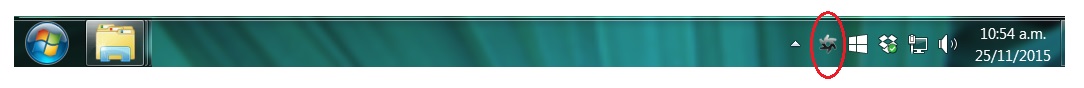

hi tboom, you probably haven't run the octaneserver.
before you can render with octane for blender, run the octaneserver first. it should be running in the background (an octanerender icon should appear in your taskbar notification area, at the lower right corner of your screen)...

thanks for the screenshot, the server version doesn't match the blender octane edition demo build.
I just checked the demo versions at the demos page:
Blender Octane Edition - 9.3 (2.75).exe
Octane Server DEMO - 2.23.2 - 9.3.exe
those two should match, in your one the octane server it's not 2.23.2 - 9.3, thus you get the 'wrong renderserver version' error...
