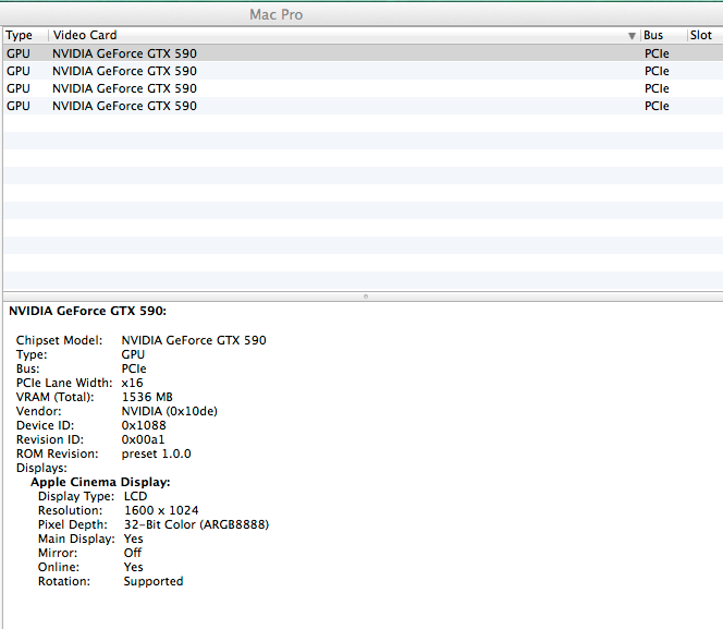

georgesemmanuelarnaud wrote:I am wondering how many GPU , card, OSX van andle, thinking about going on Windows of it can handle more....
Oxs mtlion |2 Geforce GTX780ti | i7 3770 | 32GB

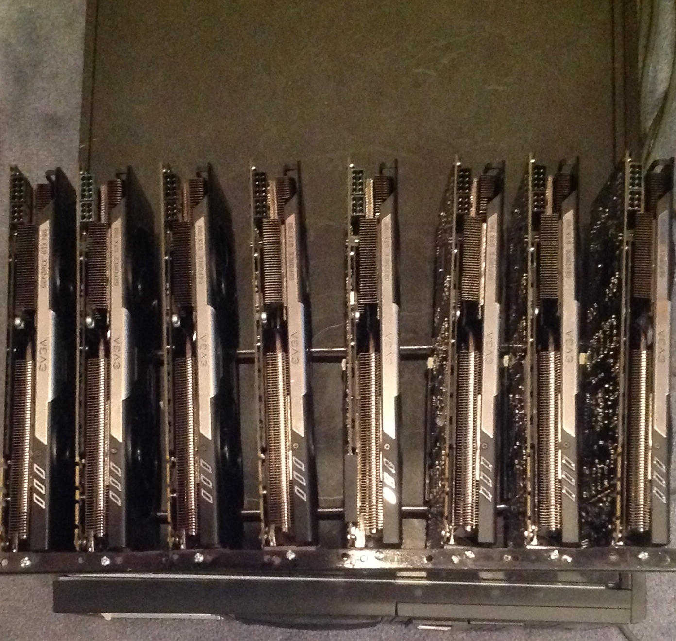

A classic MacPro (cMP) has four PCIe slots, only one of which was intended by Apple to run one double width PCIe video card. However, one can hack those cMPs to run internally up to 3 double width GPUs - IF ADEQUATELY POWERED. cMP can run at least four GPU processors with additional hardware, such as the Amfeltec Clusters and Splitters [ http://forums.macrumors.com/showthread. ... 21&page=49 - See posts #1222 - 1241]. Mavericks*/ can support between 4-5 CUDA GPUs depending on the particular card's IO space implementation [ see discussion of variables here: viewtopic.php?f=40&t=43597&start=140 ]. I can run, at least, 2 GTX 590s (dual GPU video cards) in any of my cMPs**/ . [See second pic, below]
Answer: Tyan and Supermicro have the best preconfigured platforms for massively parallel GPU computing systems. But they're not cheap unless you're willing to do much research and learn to live outside of the box containing others ideas of beauty and forgo that new computer smell, or learn to do your homework and build your own.
*/Given that I have 24 rendering systems, I don't have the time to play that game where each Apple update breaks the Nvidia web drivers (since the Nvidia web drivers are tied to a particular Apple update). That's why I'm not in a hurry to upgrade my four Apple systems to a later version of Mavericks or even Yosemite. But keep in mind that on Macs the OS level determines which drivers will work, and thus that determines which GPUs you can run in them successfully.
**/ I run the overwhelming majority of my 116 GPU processors under Windows and Linux in systems that I've built.
P.S. 1. For the hackintoshers - as indicated in my thread here - viewtopic.php?f=40&t=43597&start=140, not only does the motherboard determine how many GPUs can be run successfully, but, among other factors, the OS also affects that. Since GPU processing is a new frontier, you have to be willing to take risks to determine what will work with what. As an alternative, you may have to learn to borrow GPUs from your nearby friends for your experimentation.
P.S. 2. As to which video cards to use, I recommend that one's GPU cards be of the same version/model/feature set to avoid IO space, i.e., lack of resource issues.
P.S. 3. I am not aware of any GPU expansion box solution, cluster, riser, splitter, etc. that can extend a computer system's ability to handle a particular number of GPUs above the ability of the motherboard's IO implementation to support that number of GPUs; such add-on solutions appear currently to only provide additional slots into which to plug GPUs (and/or other PCIe devices) where the inhabitants of the physical PCIe slots of that motherboard (and other non-obvious PCIe users such as, but not limited to, memory, SAS and SATA) have not already exhausted all IO reserves.
P.S. 4. Of the GPUs that I own, the GTX 780 TI ACX SC OC appears to be a IO resource hog and, in particular, does not play well with different GPUs as far as IO resource limitations are concerned.
Because I have 180+ GPU processers in 16 tweaked/multiOS systems - Character limit prevents detailed stats.
Hey Tutor,
that's an impressive setup you've got! And I thought I was rivalling the NSA with my quad 780Ti setup... haha.
Have you ever come across a Yosemite solution for the GPU limitation? I just upgraded to Yosemite and the bloody OS only finds 3 GPUs now (of 5). Fortunately I was anticipating problems and have a boot mirror with 10.8.5...

balt wrote:Hey Tutor,
You will never have them back unfortunately in Yosemite, Mavericks might give you 4. And I'm pretty sure if you took 2 cards out leaving 3 only 2 will show... Thats what was happening in my testing...

Hi Folks - i had the same ugly Problem - came from Mountain Lion with perfectly working Netstor NB255A over PCIe and good speed with 4 GTX titan inside.
Yesterday updated to yosemite and didnt heard about the GPU limitations before.
Now i only see the GTX 680 ind the Mac and only two Titan in the external box.
Apple said they can not help - it is third oarty problem - thank you apple - but before updatetd it works perfect.
the problem is that i need for expl apple motion updatetd but this only work with the newer system.
i read that mavericks before 10.9.4 maybe can handle both - 4 x titan and the new motion
so i will try
but i got an terminal line for Mac pro 6.1 that will stop the limitations for the GPU - but only when you use thunderboldt
here it is - maybe it helps someone
nvram tbt-options=\<00\>
i think apple will not have any Professional user in the future - so i had to change to windows after 24 Years in the Mac world - what a ....
cheers
carsten
