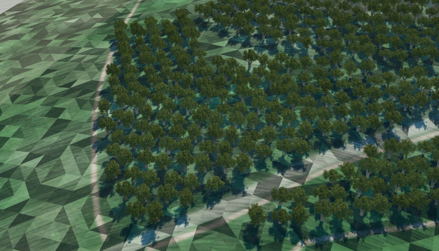

Thanks, but it wasn't that. I figured out what it is, it was the displacement map on the terrain. When I removed it, shadows appeared again. However, because the terrain has been Zremeshed it has these wierd artifacts that only go away either when the terrain is made very small or when there is displacement on it. Can these artifacting be fixed somehow, cause I tried everything I can think of? (see attachement). This normals artifacting doesn't appear in Arnold for example.
I read all I could find on the forums but suggestions didnt work, e.g. importing without vertex normals and in proper scale.

I think I'll have to scale the whole scene down and use that as a workaround.
Posts: 10563
if your scale settings are incorrect or in extremely large scenes, you have to play with the rey epsilon value in the kernel settings ;)

Yep, this looks like a ray episolon issue.
