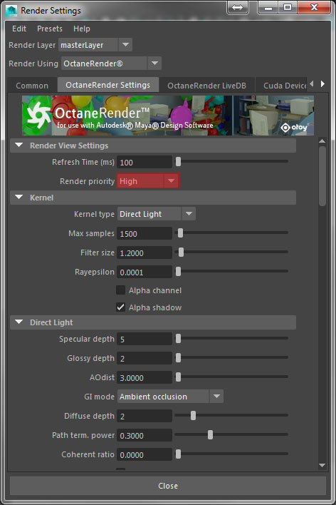

done some digging and managed to sort it
make sure render priority is set to high in the global settings, it defaults to medium and restricts the cards

Having the same issue. 3-7 times slower in maya and I have it set to high priority.
