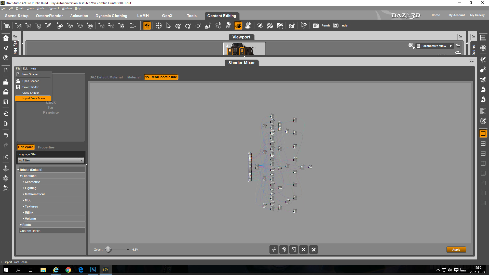

-> Question: which Iray bricks create results that are similar to glossy materials
To answer the question we can
- select a surface in the scene with the surface selection tool
- Open the Shader Mixer (this is not the same as the Shader Baker)
- select File / Import from Scene
This will now show the Node setup of the imported surface of the Iray Materials similar as the Node Graph Editor in OcDS.
At first glance this can be a bit confusing. But at second glance you may start to see a logic.
- In Iray the "User Parameters" are on the left side.
In the middle there is the node for PBC Metallicity Base.
Side Note:
In OctaneRender we have the main Materials
- Diffuse
- Glossy
- Specular
It seems in Iray the main nodes for "Base Mixing" are
- PBR Metallicity / Roughness
- PBR Specular / Glossiness
- Weighted
The big challenge is now to figure out which exact settings define the look of the metallic surface in Iray and how can that be translated into an OctaneRender "Glossy Material"?

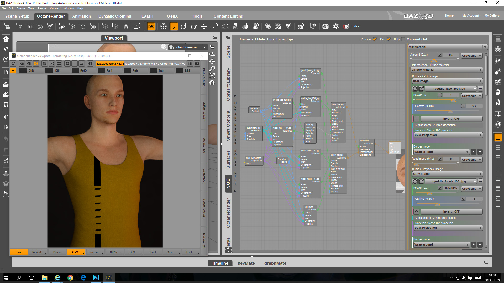

Iray Materials Autoconversion for figures - Diffuse map is not carried over
It seems many Iray material presets that use both normal and bump maps in combination with diffuse maps end up as a gray mix material in OctaneRender.
For some reason the Diffuse maps are not applied during the Auto Conversion.

The idea of a complex material auto conversion is that not only just the maps are copied over but also individual values of nodes as far as they are compatible. :!:
Example: A smart complex auto conversion will actually also carry over and convert individual bump and displacement values and in the best case scenario also the index of refraction etc.
All you are doing with templates is to apply the SAME VALUES to all surfaces. The only thing that is different when you are using templates is the maps applied.
Templates are certainly a great start for figures when you want to restart with the same values all the time.
Nevertheless when your goal is to create huge scenes like environments with 100+ objects and 250+ materials on 500+ surface zones the last thing you may want to do is to use a small selection of templates to make them look like the are all the same type of stone, plastic or metal.
