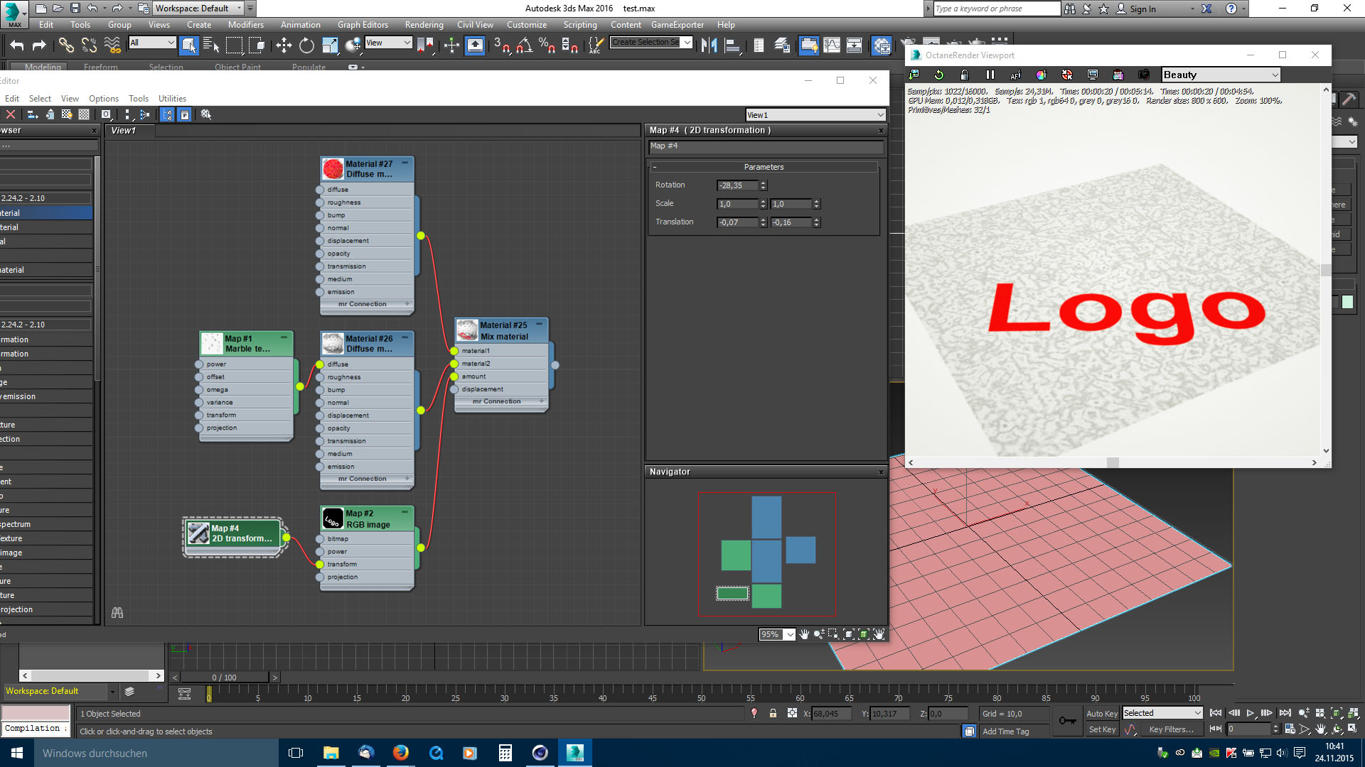

So I see that you have a MIX material to mix two materials together, but how do you COMP one material over another ? For example a LOGO over a base material ? Like a wine label over a base glass material ?

You can't. It's a current limitation and it has been requested many times :(

profbetis wrote:You can't. It's a current limitation and it has been requested many times :(
wrong,,, you can...
Just connect two materials into mix-materials channel 1 and 2,,, and connect into amount an alpha image,,, thats it.
Here comes a screenshot and the scene out of max 2016.
Octane-Max_MixMaterials.zip
(337.28 KiB) Downloaded 188 times
Hope, that helps.

richardyarlett
Posts: 197
Joined: Thu Apr 09, 2015 8:48 pm
No that is not the same thing. That simply mixes two diffuse textures together. But they share the same overall material parameters etc. They are the SAME overall material. I am talking about two totally separate materials, maybe one diffuse like brick, and one glossy like glass, and comp them together. Basically the same as MIX but not at the color level but at the entire material level.

Hi richardyarlett,
aren't you looking for that?
Label on glass?
That's the way it goes.
Here is the max scene...
Label_on_Glass.zip
(374.04 KiB) Downloaded 208 times
Or am I misunderstood it again?
You wrote that you are looking for a solution to put a label on a glass.
Cheers,
Can

Gestaltdesign
Posts: 60
Joined: Sat May 23, 2015 7:14 am
Hi Can,
Just to say it is nice to see there are users here willing to take the time to help, as I read it you solved the OP's problem.
Good to see, cheers!
