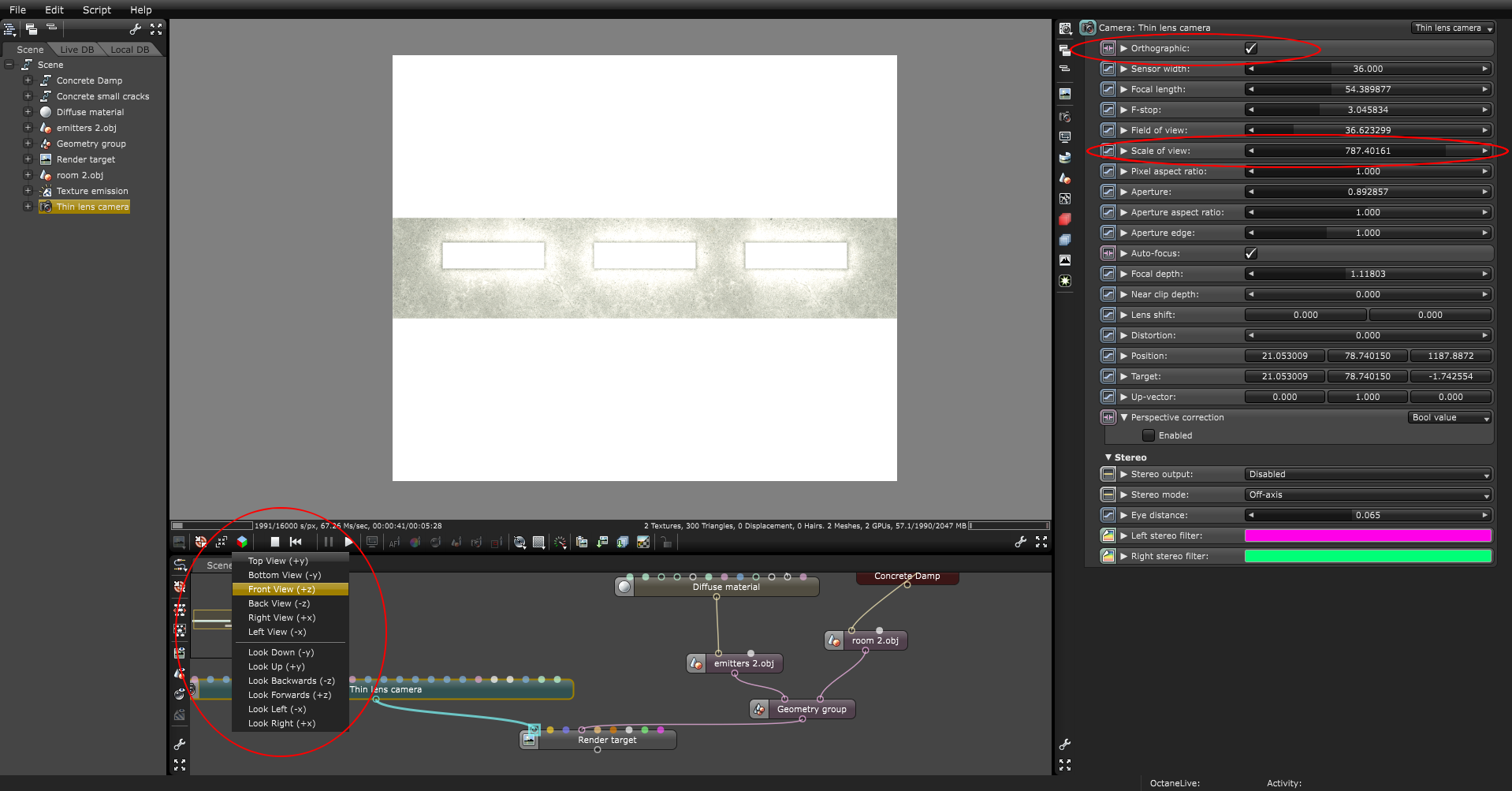

The dimensions of your room are roughly 787 x 160 x 787 (W X H X D). You exported your scene incorrectly to OBJ have a look at the export settings in 3DS max.

By using the orthographic camera. The width of the image equals the scale of view so I placed the sides of your rectangle exactly between the edges of the image and read the scale of view value.
Another way is peeking in the obj file. You will see that those vertices are nowhere near the range [0,20].
