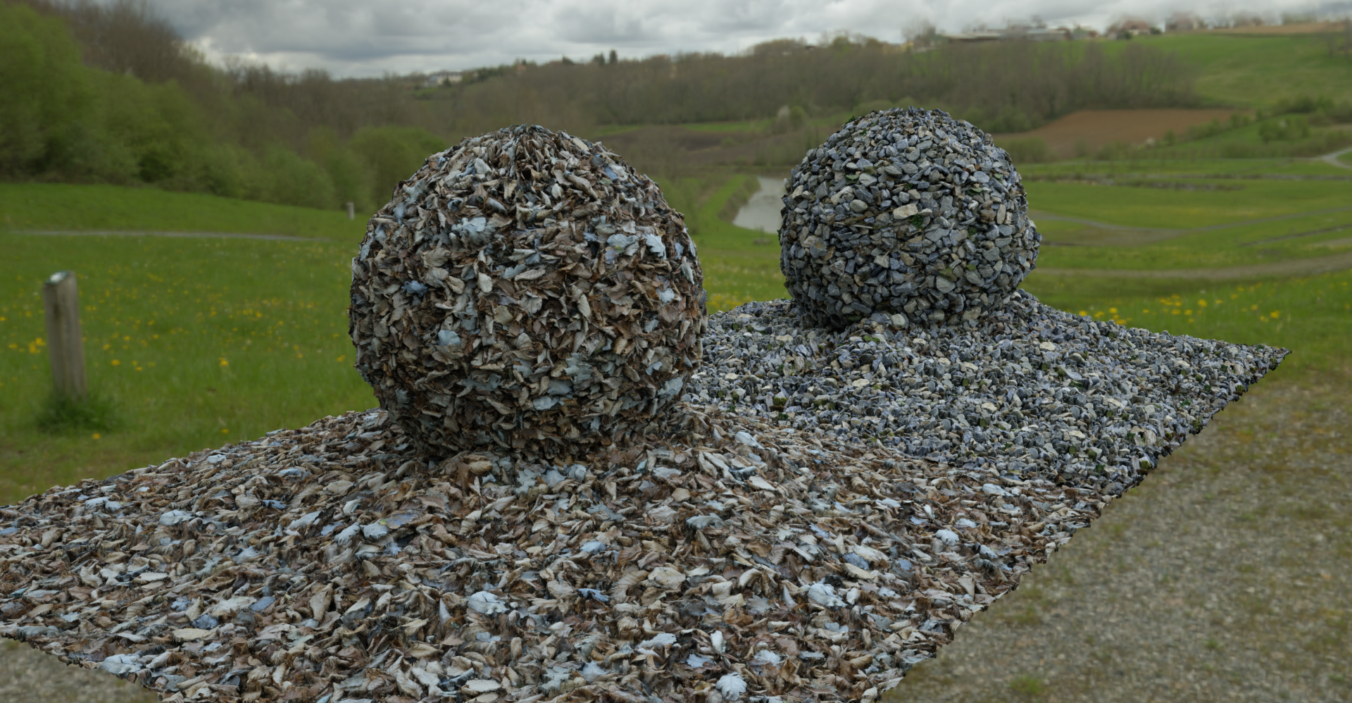

My solution for this is quite profane and I am sure there are better ways to do it.
When I have the final photoscanned mesh with color texture I simply load them into Zbrush and use the MRGBZ grabber tool to extract the 16 bit depth map and the color map. This is limited to 8k maps as this is the maximum document size in Zbrush.
The tiling for the maps I did in Photoshop using the offset filter technique. I'm attaching a rendering of two materials I have done using this process.
I tried a lot of different approaches but this one worked best for me as it does not require any reprojection. I've attached a quick render of two materials I did with this technique,
although the roughness and other maps are simply created by running the dffuse through color correction nodes, so these could be improved.

Thanks for the tips, I will try the ZBrush technique.
How did you manually tile displacement and color texture in PS the same way so they match when tiled ?

That's impressive Rahi!
I have not used Zbrush but this looks like a good reason to try it out. I would be interested to hear if there are some who have used one of the dedicated texture generator apps for this. To me it seems that deep normals like these are real hard to tile without being obvious. Are there any of the texture apps that are really good with using user images? Can't wait till there is some intelligent app that takes a photo or 2, creates all the required maps, and then makes it all procedural...
