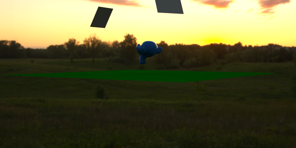

Here is an example of a bad HDR file:
Notice that there isn't much of a shadow and the shadow is very diffuse and indistinct. The area where the sun is doesn't look right because the dynamic range didn't go out far enough to capture the correct brightness there.

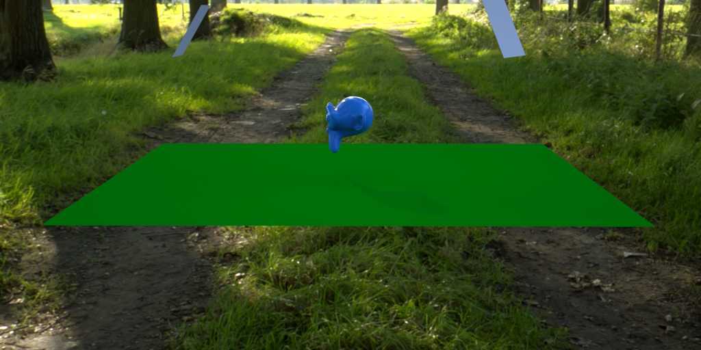

Here is an example of a good HDR file:
Notice that the shadow is very sharp and looks much better. I did change the gamma on both HDR files to 1 as they had already been adjusted.
