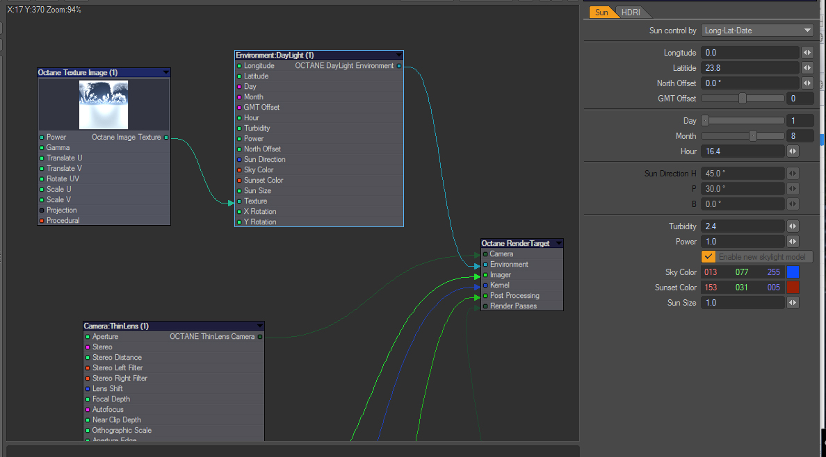

alberto.sala wrote:ok thanks!...
so with a textured environment sunlight will be active as usual?
Alberto
Try this setup (Similar to LW's Texture Environment). With the Environment: Daylight node Octane actually creates a sun that can be viewed in the IPR window and in the final render (but not in the LW viewport), it's very similar to LW's Sun Spot Motion Modifier. Throw on Octanes Post Processing node with a lil glare and your rolling.
alberto.sala
Posts: 8
Joined: Mon Nov 09, 2015 2:35 pm
yes yes... I understand that, I was thinking that environmental texture will override sun settings.... but not
it works!
thanks again
Alberto
