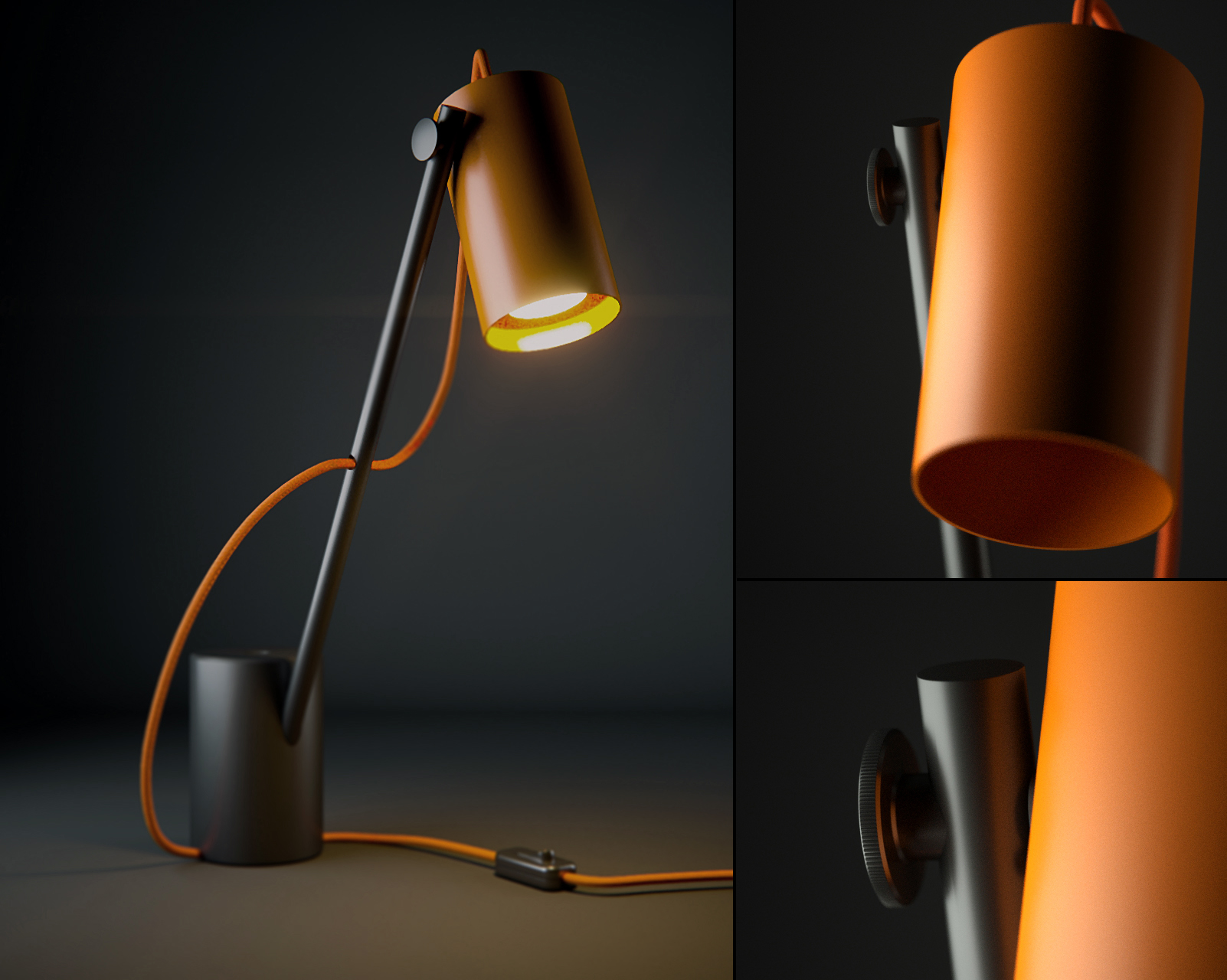

Yes, studio type shots can be much more forgiving on GPUs... but 20x, 40x, 80x speed increases are even better.
Have you looked into HDR Light Studio?
