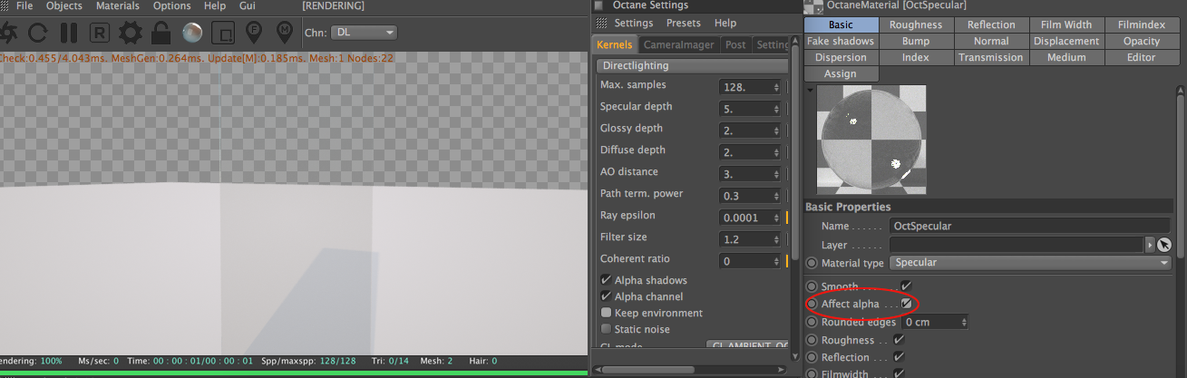

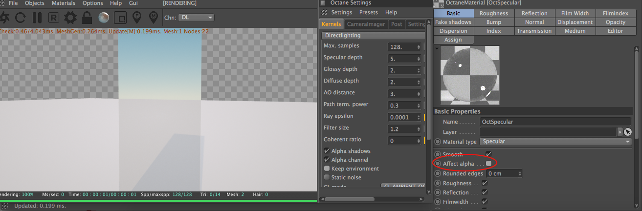

you have to activate the "Affect alpha" option in the Base tab of the attribute editor of the material:
before
before
after
after
