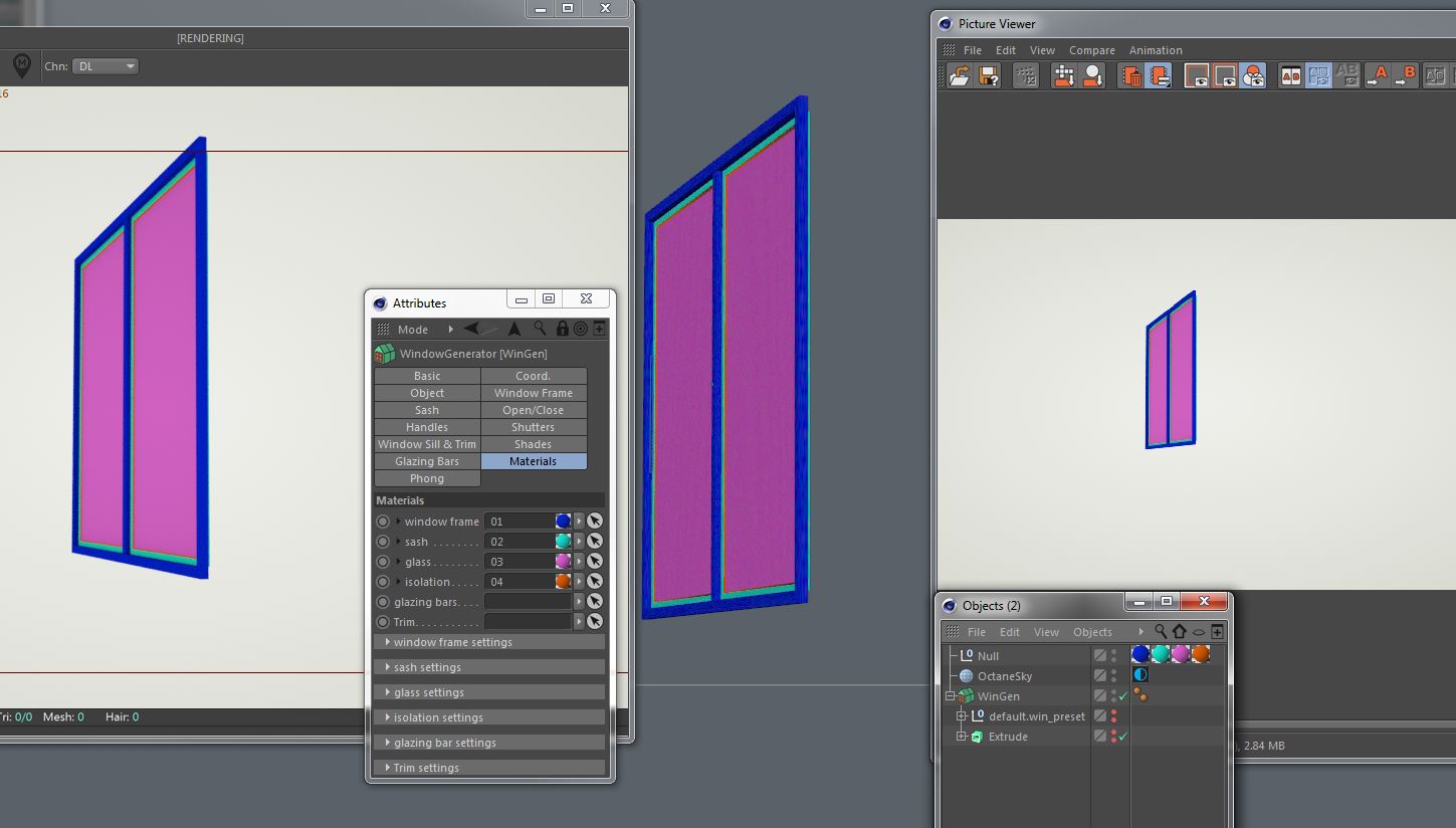

i discovered this problem when using the plugin WinGen http://www.dns-plugins.de/winGen.php
when i use now manual or all objects movable it renders in PV but without materials.
in the LV everything is ok. the materials are not on the wingenobject itself. it has some materialslots where you can drop your materials in. it is like a userdata field.
when i add a nullobject to the scene with all materials of the wingen object, the wingenobject renders with materials in the pictureviewer.
I suppose that's related with latest addon. Which is about unused material optimisation in PV.fuchsundvogel wrote:i discovered this problem when using the plugin WinGen http://www.dns-plugins.de/winGen.php

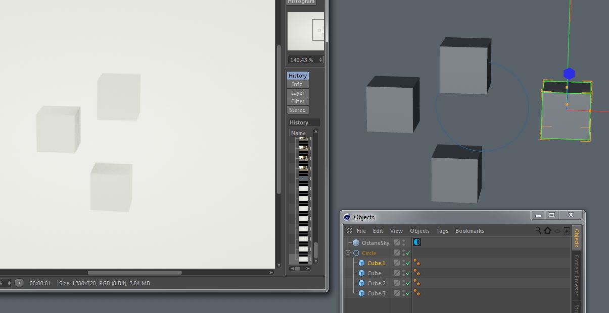

Hi aoktar,
thanks for your great work! We have switched to octane for our LEGO web series and love the plugin
But we've got a strange behaviour here:
When using an animated C4D camera with focus distance = 0, everything is ok in standard viewport.
But when using the LV or rendering the animation in picture viewer, the camera jumps around randomly.
Win10 64, C4D R17, 2.24.x
Any ideas or hints?
Thanks & best regards!
Paul
Any ideas or hints?
Paul
sample scene pleasefuelnewmedia wrote:Hi aoktar,
