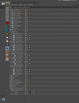

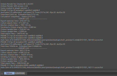

The scene file is quite big (500mb) and I've attached a console screenshot and object manager screen to show when it seems to bog down the render times.

First your scene is away from optimised ways in a few points. I'll ask some questions to indicate the serious mistakes.
1- I see 49890 movable meshes on frame 211. Means lot of mesh are seperated and you assumed each one is animated. Are they really animated? Try to put object tags to just only animated groups and don't put to static objects. And better optimisation, try to use manual assignment method in Render Settings.
2- I see that you use vertex/transform method for motion blur in tags. Do they really have deformation animations? This causes to cache vertices of all objects per frames. Very bad idea if you don't want to explode your ram and cpu. Also very time consuming process for so much object counts. Just use transform motion blur if they are not.
3- You should use render instances when it's possible. You said the reason but should be some parts convertable to render instances.

Okay I found what caused it, had some cloners I thought I instanced that weren't.
That was 40k animated meshes that was unnecessary.
Got the render times down by a really large chunk now, only 1.5 minute of loading per frame now.
