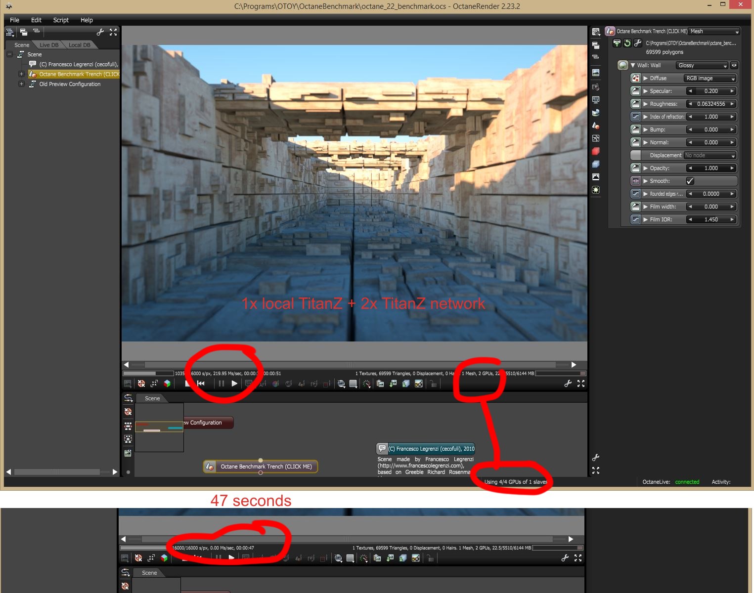

Did some test for you:
rendered the OctaneBenchmark with a local TitanZ,
and then added the two TitanZ's as network slaves.
If lineair the results should be triple renderspeed and it is.
The rendertime to load this scene over network was about 3 seconds.
(after 3 seconds the renderspeed jumped from 72 to 216 MS/s).
