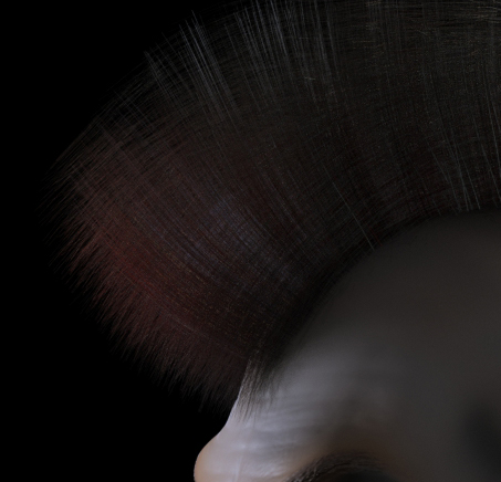

Heya, I'm making a character with a mohawk. I made the fibers in Z-Brush and they load fine into LW. I applied a color material to the hair and it works great, but I'm getting 2 sets of hair rendering on top of each other. The basic mohawk, which is what I want and another set of hair that renders kind of horizontally instead of vertical. I attached a pic of this. The mohawk is drawn in the LW interface just fine, where this second set of hair is coming from, I don't know.

I figured it out. Kind of. If I have object turned on in FiberFX it renders two sets of hair. The straight mohawk and the fuzzy hair on top. If I uncheck the hair objects in the FiberFX panel, it then just renders the straight mohwak hair. Weird, but it works.
