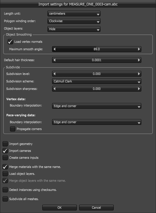

The other hurdle in figuring out Beeple's animation is that last I checked, c4d cameras didn't translate to Octane standalone very well, so if we were to use ORC at all, we would need to reanimate his camera (not too crazy in this case), or figure out a way to bring across the data. I do believe the newest version of the c4d plugin has some kind of cloud render button which probably means that issue will be resolved soon?
Posts: 10598
the equirectangular pano images are recognised directly by ORBX, no need to edit the json file ;)
About the c4d camera export, for now, export all the cameras(animated or not) via alembic c4d exporter:
in standalone only verify the correct scale to match the alembic ones:
then use this scripted graph to transform an abc node into a thin lens or panoramic camera:
