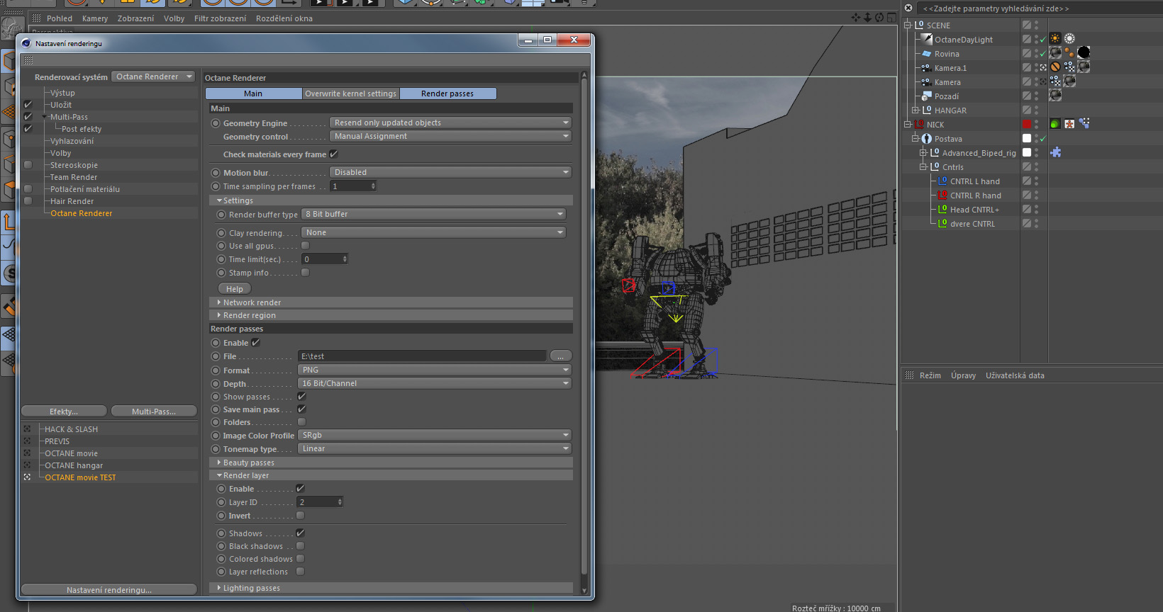

Hi, I would like to render character animation - my character changing positions only if I set Geometry engine on "Resend all scene data".
I would like to render it as a layer but it works only if i set Geometry engine on "Resend only updated object" but then my character doesn't move.
Is there any way how to resolve it? Thank You.

Mibu wrote:Hi, I would like to render character animation - my character changing positions only if I set Geometry engine on "Resend all scene data".
It's not expected behaviour. Maybe a ignorance due hypernurbs or so. Can i see something about your scene?

I tried switch Hypernurbs to off but still the same. My character is moving only if I set Geometry engine on "Resend all scene data".

Mibu wrote:I tried switch Hypernurbs to off but still the same. My character is moving only if I set Geometry engine on "Resend all scene data".
Have you had object tag over geometry? Is it moving in LV? Ex. when i tried some character scenes from library, they works well.

I created character object and then put geometry objects under bones. For some reasons I can't used binding etc. I know, It is not very typically but In LV it works very well.
I tried put object tags to every object in my character hierarchy but still with no success.

Theoretically it should work if it's fine in LV. As a workaround try to force updates.Maybe animate something on these objects or put a irrelevant tag and animate. I can check that if you share that.
