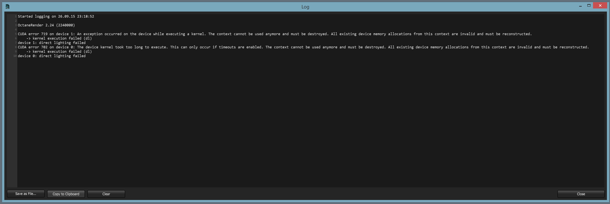

you can tell me what the cause of this error, and how can I do about? i used 3 titan x and i have enough memory...

I could fix the problem 702, it was timeout problem....
"- Launch the regedit (Start -> Run window -> regedit)
- Go to HKEY_LOCAL_MACHINE\SYSTEM\CurrentControlSet\Control\GraphicsDrivers
- The key "TdrLevel" should be set to 3.
- The key "TdrDelay" is the delay in seconds. Maybe set it to 20 or 30."
however for error 719 I have no idea....

In general, I get 719 errors from over heating the graphics card. But it might be something in the scene too. Check you card temps first, and if they are fine, pls send me the scene.
Paul
