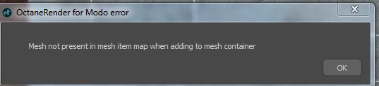

Not sure what this means? But I just have to click okay and then it continues to render. But if I don't click okay then it pauses. Any way to fix this? I have a very long render to do so I will be rendering over night the next couple days..

I suspect you have animated the visibility of a mesh in your scene. So the mesh is not visible in the first frame, but becomes visible at some point in the animation - and when the plugin updates the mesh vertices, the mesh container (the Octane Placement node) has not been created. Rendering animations requires all the meshes used in the animation to be visible in the first frame.

Thanks for the input. I finally found that mesh and deleted it. Everything works then. I don't remember having anything animated to hide. But oh well, problem fixed.
