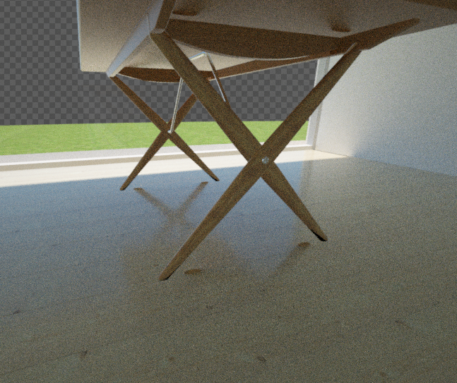

i have a strange reflection 'offet' on my floor texture - does anyone know why this happens and if i can fix it?
the table does intersect the floor
thanks :-)

I think either your ray epsilon is too large or your scene is scaled too small.

hi abstrax
that was spot on - thanks :-)
