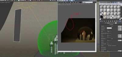

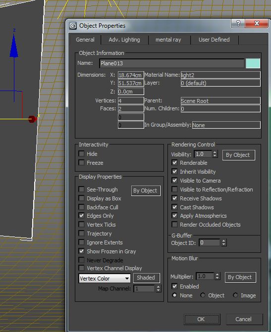

Hi guys,
How do you hide reflection / refraction on light material or objects ? max object properties doesn't work in octane.
I can get invisible to camera working but it still shows up in glass reflection?
J

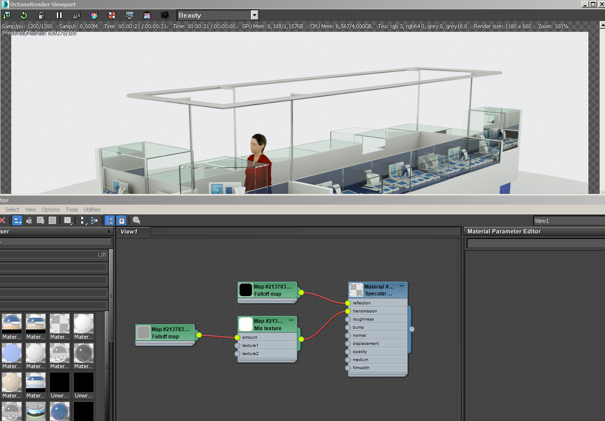

Goldisart
Posts: 780
Joined: Sat Oct 26, 2013 8:47 am
after many tests came to the conclusion that the fast glass has such a structure / map Where the reflection falloff adjusts the external card and mix through falloff adjusts the color of the glass

Do you mean reflection value in glass material shader ? can you screen it pls
what I need is to exclude some lights in reflection, it can be done simply in vray. Is there a such function in octane?
For example I have objects / a few small lights inside the glass dome that I dont want the reflection to be seen in the glass.
Another question is the object inside the dome seems to be really dark, what can I do to make it look lighter without turn up the power value of the light ?
