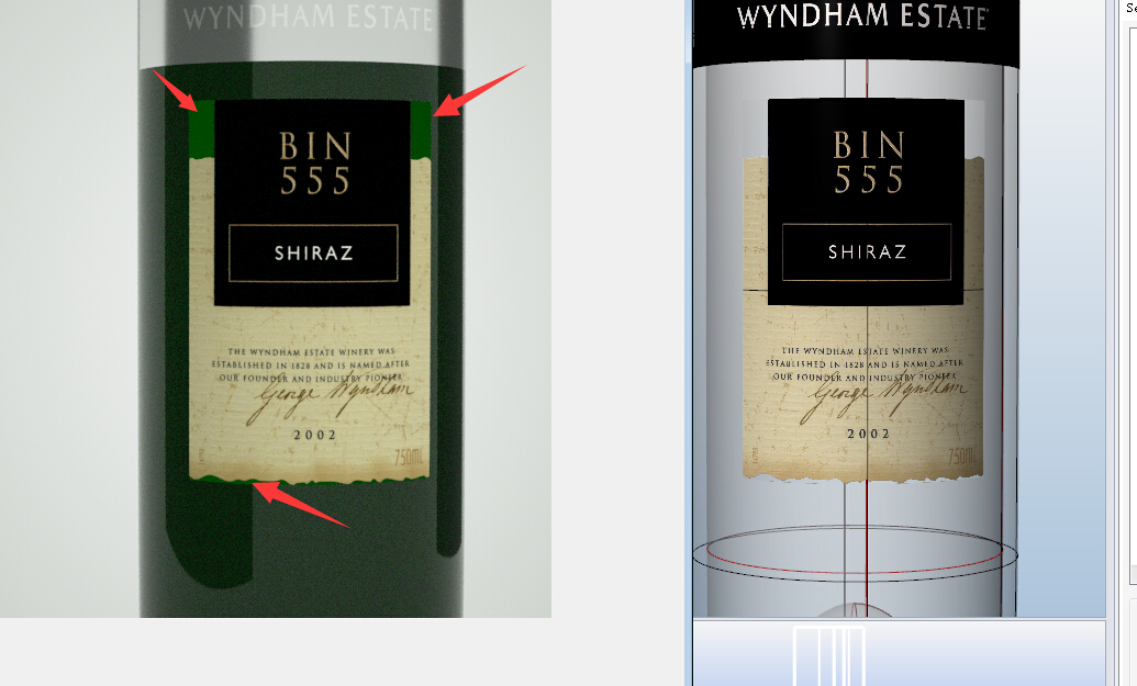

I use the Octane for rhino long time and find this bug, I wish you to fix this bug.
1. Environment- Texture Environment to select HDR file for Lighting the scene, You can find the HDR Environment vray dark but object is very bright, this is not true. Please Fixed this.
2. Put on a Alpha label map(transparent) on the glass object. You can find It's not totally transparent. It has a light reflection. Please Fixed this.
3. I can't set a picture for render Background picture like compose object images and background picture together. Does this function work?
Assign a Grayscale Image to the Opacty with the Labal-02 Alpha.jpg image.

No, it does not work well. Look this
And please save your file send to me. Thanks
I suspect you have edited the wrong material. The material for that label is called "Label-02", whereas you have edited material "Octane Material 001". Also, there is a material update bug which is fixed in the next release which might not be helping - so "Refresh" to be sure the new material as been applied in the Octane scene.

I have updated the version: 2.24.1.50. And the lable is not work well.
I upload the file to you, Please help me. Thanks
The material is correct, however the vertices of the label with an opacity of 0 are causing self-shadowing issues with the vertices of the bottle causing the green color you are seeing. Setting the kernel->ray epsilon slider to it's minimum value seems to fix the problem.

Hi Paul,
ok, it works done. Thank you! :D
ray epsilon is the shadow ray offset distance. Why does it affect the transparent label map display?
I think the green you could see was actually the green from the bottle reflecting only the back of the label. The vertices of two meshes will cause artifacts if there are within the ray epsilon distance of each other, and one of the vertices has an opacty < 1.

Hi Paul,
I have updated the new version: 3.0.0.57.
I have Set the kernel->ray epsilon to 0.001 (default value)
Then I have Set the kernel->ray epsilon to 0.00001. The glass shows a black point. How can I do?
