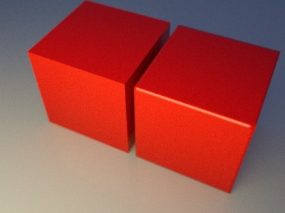

roeland
Posts: 1823
The rounded edge feature works but it has a few limitations. It is very dependent on your scene if you'll run into these limitations or not. Generally speaking if a mesh has very narrow triangles near the edges then you'll get artefacts.
This is a common case if you are modelling 3D parts with holes and curved edges:
Note how the triangle marked in yellow skirts the edge of the hole. When using rounded edges on that mesh, you get an artefact on this triangle. Improving this is on our to-do list but it's not something we can easily fix.
Roeland
