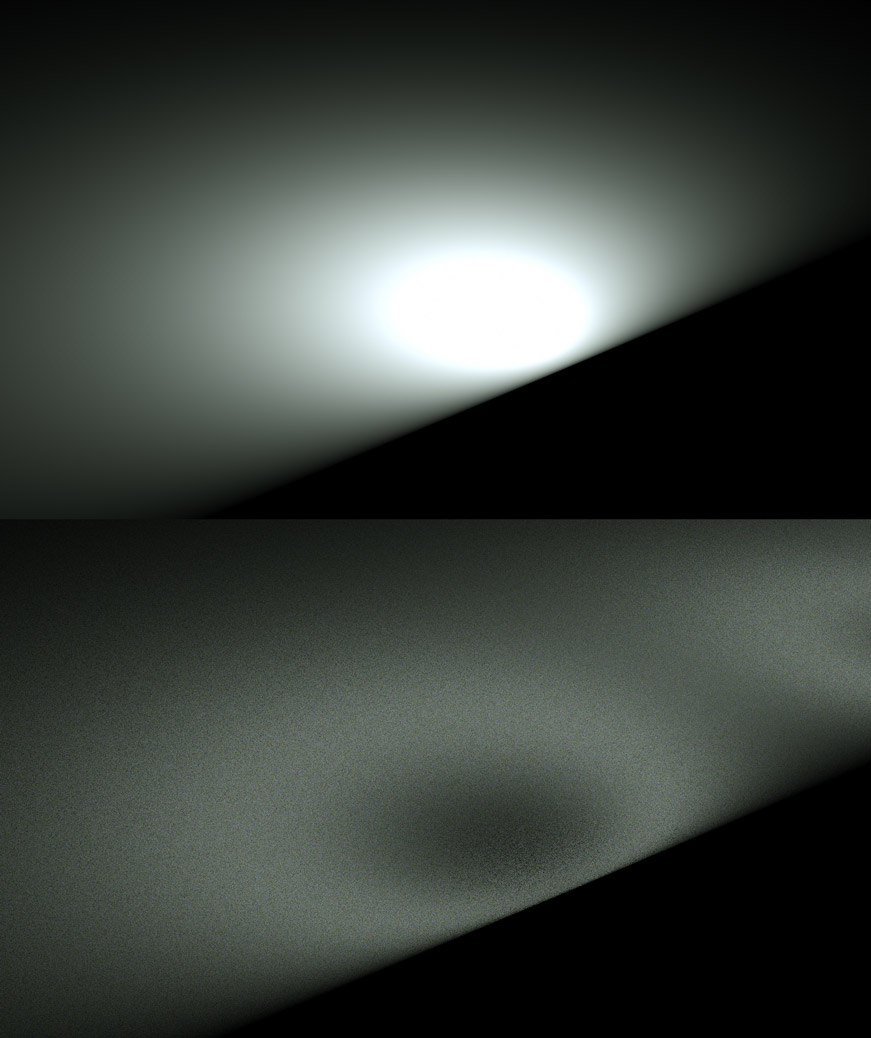

I've been experimenting lately with setups that use a lot of lights and I've found the following odd bug.
In the attached image the top section is rendered using one light and the one on the bottom uses that same light , in a cloner and duplicated 200 times (used this extreme number to show the problem).
The noise is normal since now it has to sample 200 lights instead of one, but the decrease in power and that weird shadow in the middle is not normal.
Can this be resolved somehow?

There are two problems here :
1.The problem that worried me the most is the shadow that appears in the center of the light. What is that?
2.The second one is the dimming of the power with the number of lights
I've tried also with the object tag and I get the same problem : the decreasing power of the lights while increasing the number of lights.
See the attached image and scene. Render once with all the lights and then delete all but one and render again.

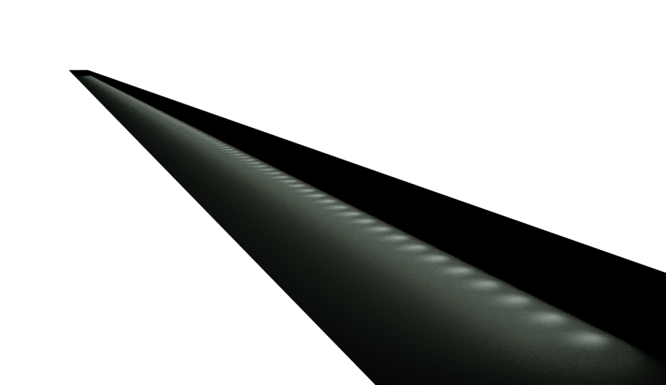

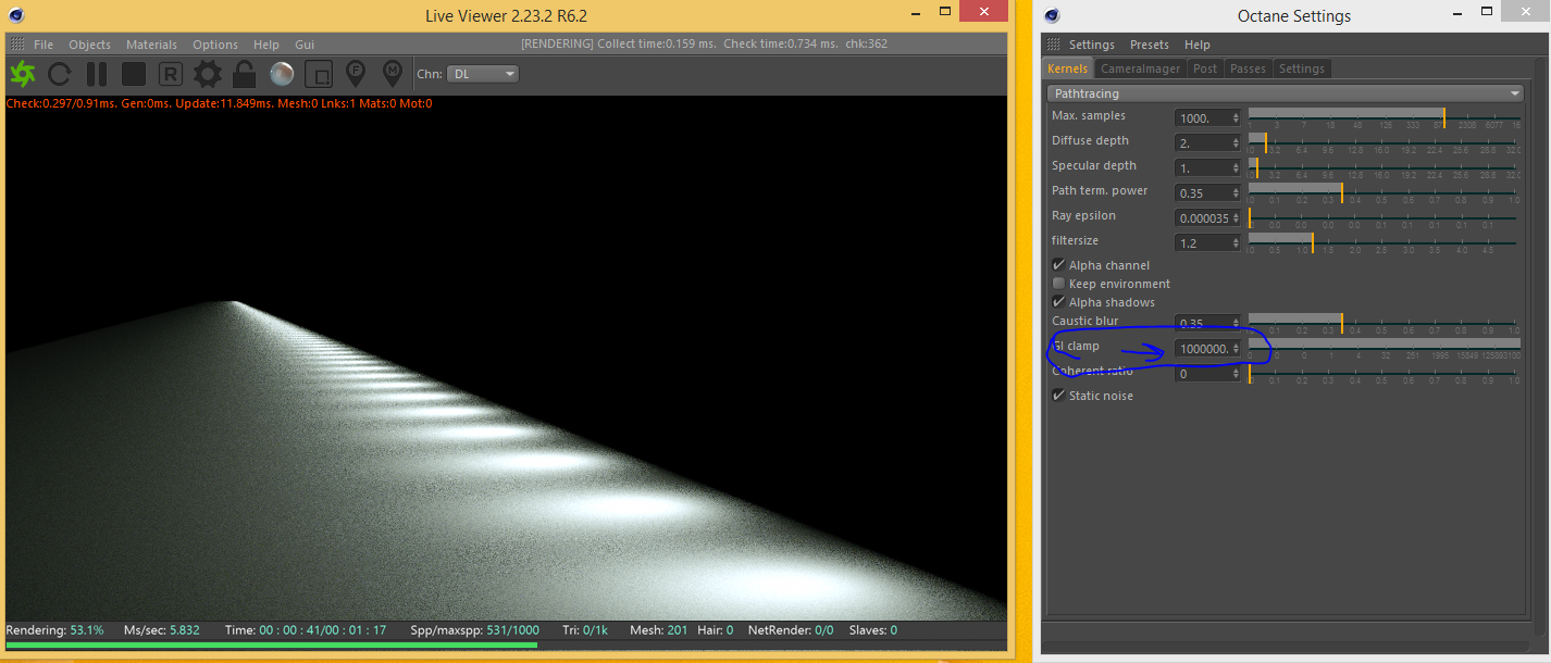

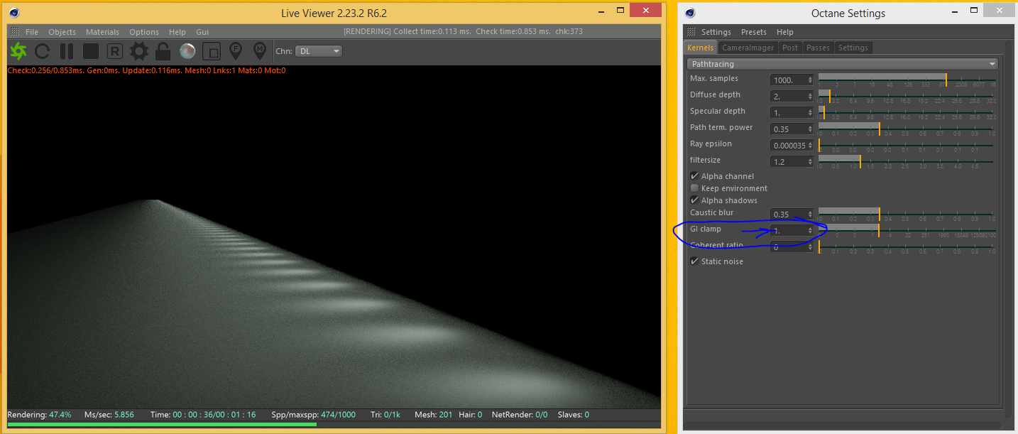

And about "the decrease in power" - it's because of GI_Clamp value . If it's set to "1" then you will have dimmer lightstomabobu wrote:Hello,

Thanks Uncia for your help. It's great to have a solution for this.
Is there a situation when the "Opacity" slider is usefull? Or it shouldn't be touched ever.

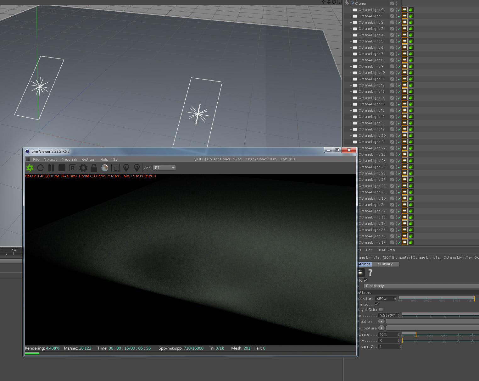

Also the problem still exists if you use "Direct Lighting" with a any of the methods other than GI_DIFFUSE.
The center of the lights darkens and the light power dims with the increase in the number of lights.
Is there a workaround for this situation?
