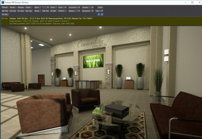

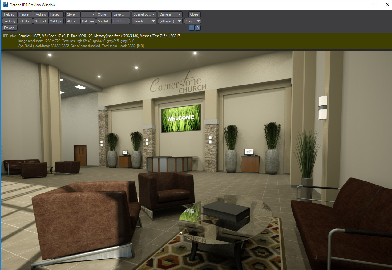

ok I can confirm with a test that lights in another room that are not visible will AFFECT the sampling rate of other lights. Notice in these two images that I actually have more samples in the more noisy image (which has the lights in the other room (just past the welcome sign) all turned on. But you can see in the cleaner image I don't have as many samples and a similar sampling rate and it's much cleaner. This means that with the other lights ON they are getting focus but are not being seen....
I hope this can be addressed with a quick update. I do not want to have to create different scenes and models for these kinds of projects just to keep the render times down. Looking forward to any feedback.
