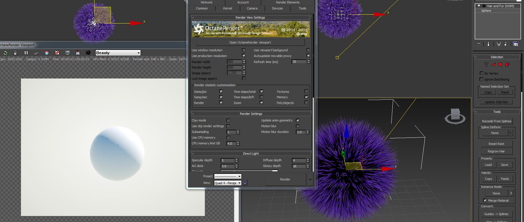

Hello,
How does Octane work with 3dsmax standard Hair and Fur ? I have tired it appy it to a sphere nothing shows up in Octane view port?
I couldn't find any instructions in manual either please help. I am using max 2013 latest octane render
J
jim99
Posts: 74
Joined: Wed Aug 19, 2015 6:07 am
ok I got it working by turning on hair geometry option, but how do you render out just the hair pass with a matte shadow shader ?( if there is one ?)
