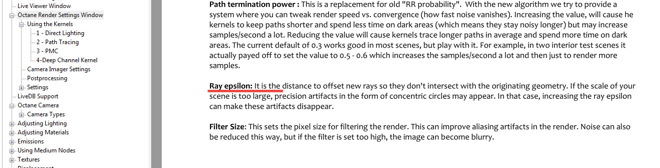

you have to rise the ray epsilon value in the kernel setting to match the bigger scale ;)

awesome, that seems to fix it perfect! Thanks so much! I always wondered what that setting was for!
Is it the best idea with that setting to keep the value as low as possible, without getting those artefacts?
