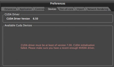

Hi ahmet
i tried to install your last 2.24. and the stand alone
but i get an error - i must use cuda 7 -
but in my osx the highest cuda is 6.5 i can get
mountain lion 10.8.5 -
i tried mavericks and Yosemite but then i have a GPU limitation of 2 Cards.
From my external 4 Titan Cards are only 2 shown.
i was in contact with apple and the Engineer from Netstor.
apple said it is not their problem - hihi - funny but it work before
they say - it is the problem of the 3th party hardware
with netstor i tried different kext tuning and terminal orders. but didn't got it to work.
so i went back to Mountain lion and i have my 4 cards back again.
i heard from a apple worker that apple don't want that my old mac pro is faster than the new mac pro.
So they limited it for only two cards. isn't this a shame for apple.
i have the latest Cuda and Nvidia driver i can get for my OSX.
can you help to get your last version run on my mac pro with Mountain lion?
cheers carsten

cbmotion wrote:Hi ahmet
cheers carsten
Oh, really? That's not good. I'm running Yosemite, so 2 cards is the best I can hope for? Would be nice if Otoy would allow some limited network rendering in the license to combat this somewhat.
