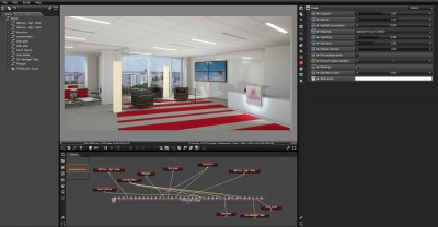

_When i export my work form Octane for Skp plugin (.ocs) to Standalone version, the graphic editor looks not as usual.

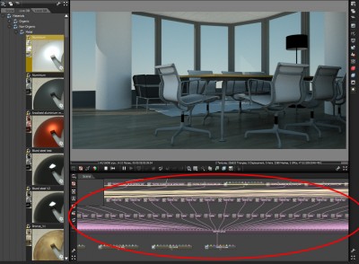

Thank you, but what a mess in Octane Standalone !
How working materials with that ?
we are waiting for a nodal approach with grouping option....
