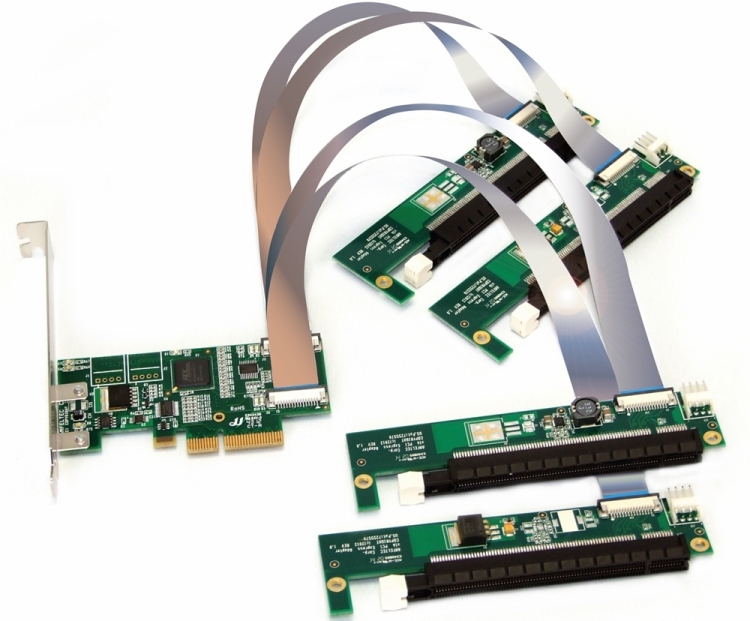

Splitter: Two of amfeltec 4way 4x to 16x splitter (I chose this over the GPU cluster due to cost and bus speed [1x vs 4x])
http://www.interworldna.com/images/amfeltec/3_adjC.jpg

I've looked into the 11pcie slot board you mentioned. (they are 10 x 2.0 8x + 1 4x which is perfect). But I can't find 4x to 16x cables.. (at least not on amfeltec site), so I'll have to go with either 1x to 16x usb cables or the 4x to 4 x 16x splitters.

The spacing between the cards will be around 3 inches after putting the cards in..(hope that's enough), so the 4x to 16x Four way splitter won't work.. (due to it's shorter cables). I'll have to use 1x to 16x usb cables instead. : (

I'll let you know after I try them. I"m still in the middle of getting my parts together.. From what I heard from tutor, they do work with the splitters. I want to use two of them to connect 3 or 4 on each splitter. I'm sure someone who's done it can tell you more from their actual experience. : )

i want to get the splitter, open up my case and split everything on this thing: http://amfeltec.com/products/gpu-oriented-cluster/
