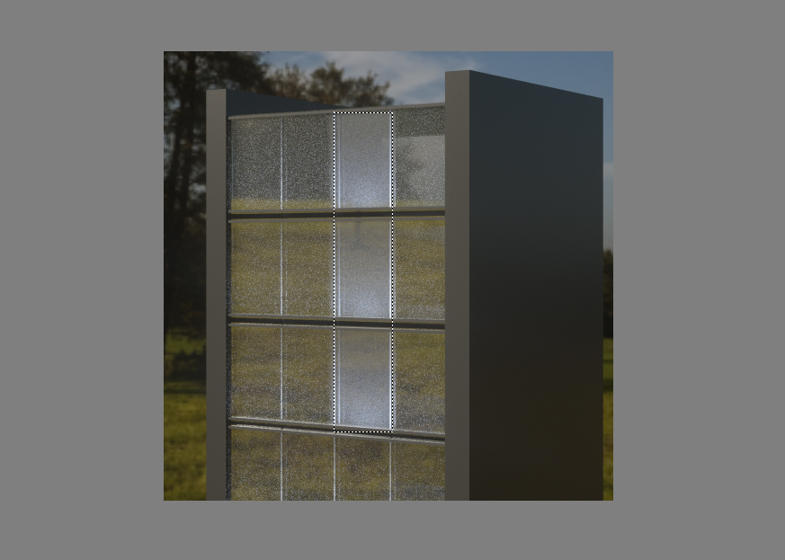

"In particular am trying to find a materials definition for opalescent glass, such that light shining parallel with the glass and adjacent to one edge creates a soft graduated glow that extends for a couple of meters - i.e light strikes glass obliquely but bounces off in a scattered way nearly normal to surface - but with out light being too bright near to light source edge, and without brightness dying off too quickly away from light source.... Nothing I try really produces a good result. Do you know of a way?"
"Like this but with glow from base of window extending up much further, and not so bright at bottom"

its a tricky one
take a look at the .orbx attached!
i put a rectangular light on the bottom on the glass panels, and the panels shouldn`t be too thick
also the glass is specular with a scattering medium-small scale, and like 0.0009 roughness. ior on the glass is set to 3 now
still, i reckon the effect being stronger when the glass panels are thinner and brighter light
the blackbody lights now are already set to maximum, but with a spotlight ies.

I just removed the .ies and set distribution to 0.7 and it seems to get more bright
also the room itself isnt lit now by the lights, just the glass
also setting GI clamp to 1-10 completely ruins the effect, so dont touch that
