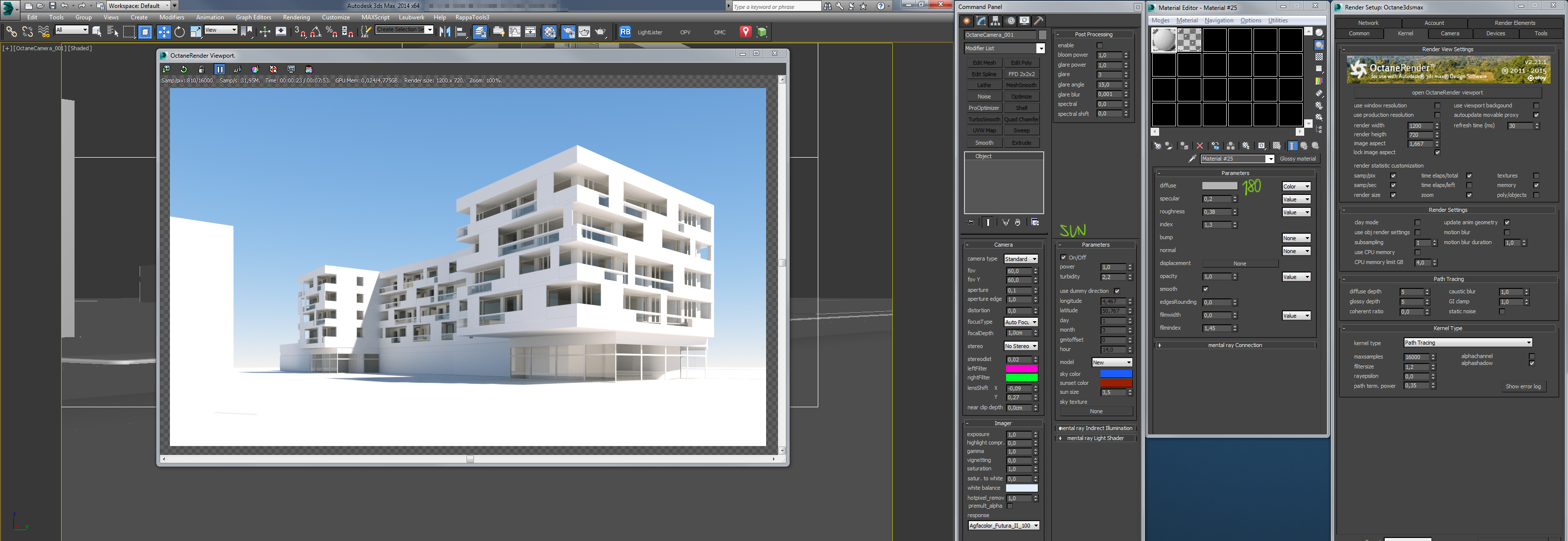

Here's the same scene with 3ds Max, I think it's a general Octane thing...
Everything is at default, I only changed the response to the same we have in Modo (why is this different actually?), white balance, the sky color and sun size.
(sorry for being off-topic, should I move this to another thread?)

Your wording is a little confusing. Are you saying modo's default sun size is 3.5? It should be 1.0.RobSteady wrote: I only changed the response to the same we have in Modo (why is this different actually?), white balance, the sky color and sun size.
You have probably saved custom defaults by pressing the "Save settings as defaults" button in octanes kernel/camera/env popovers.
You can check and reset them by doing the following
1. Select System > open user folder
2. If there is a "Octane Defaults" folder here, you have saved custom defaults
3. Close modo
4. Delete the Octane defaults folder
5. Restart modo
You may also have created a modo default scene with those values saved in it. Check Preferences > Defaults > Application > Default Scene

Will try that in Modo.
But, like I posted, in Max it's the same thing: everything is too bright with default values

That's how the defaults (when environment = daylight is enabled) work in standalone too.RobSteady wrote:Will try that in Modo.
EDIT: A few versions ago, scenes using a physical sky were extremely bright (requiring manual exposure adjustments) and OTOY decided to change the internal exposure of the sky to what we have now

Yes, I know.
That's why I said it's a general Octane thing.
But don't you think when you have default values, a default daylight system, a rough 0.8 grey value it should be a more balanced output?
The question came up here in our office where we used to have a white overide material for Modo and when you render this in Modo it's much more balanced.

I personally don't think it's too bright, but if you feel it should be different, it would be better to discuss this in the standalone thread so OTOY devs will see it.RobSteady wrote:Yes, I know.
In modo's renderer, when you enable a physical sky with accurate unclamped values (unclamp in env and light settings), you have to set your input white level (in final color output) to about 50 because the light is super bright.
In your example, you could argue that your material is actually too bright (0.8,0.8,0.8). If you read Disney's research paper on physically based shading (https://disney-animation.s3.amazonaws.c ... tes_v3.pdf), on page 9, the graph plotting real measurements of albedo rarely exceed 0.4, which I found really surprising.
