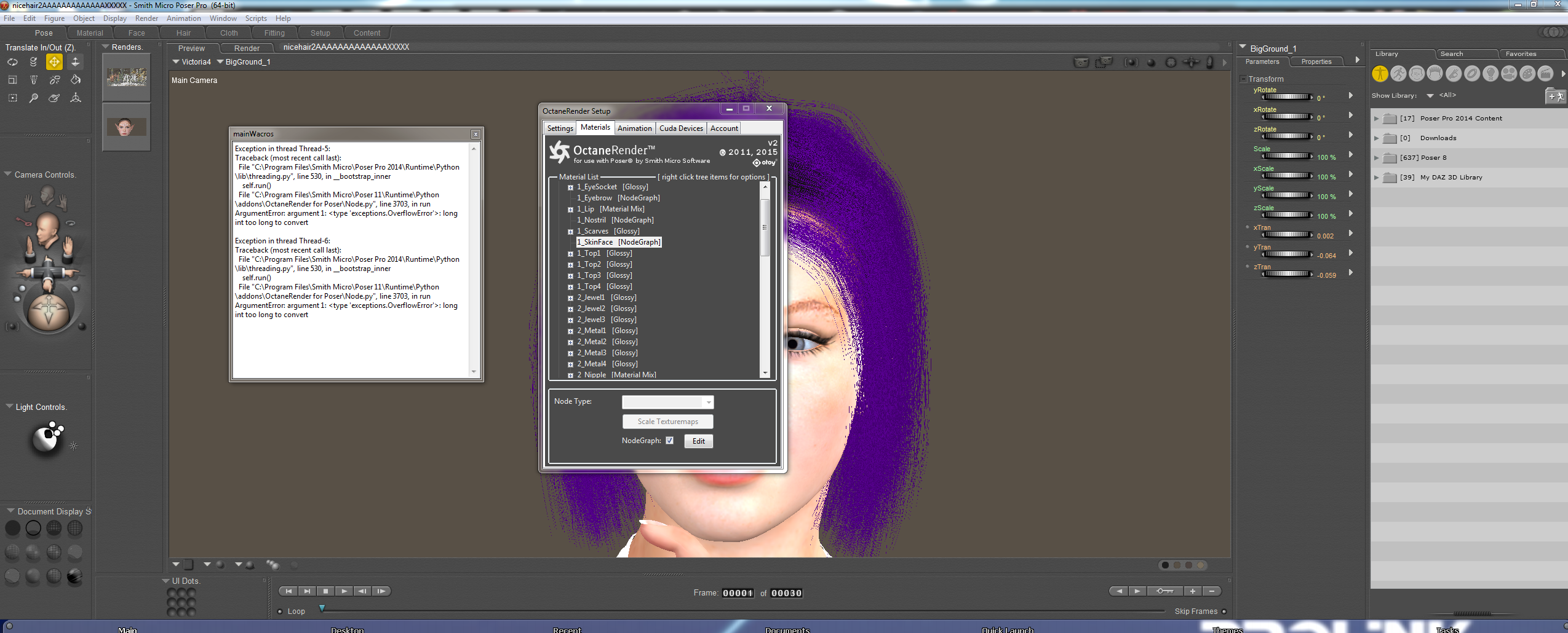

got this error after trying change it node editor
W7 64 bit |I7-3970X | GTX 780 X2(6GB) GTX 780TI X2 | 64 GB DDR3 RAM
Real Skin & real hair for Poser / DAZ Studio OctaneRender/iray - coming soon
face_off
Posts: 15822
Location: Adelaide, Australia
Can you give me more details on when this happened pls? Is it repeatable? Was the NodeGraph window open at the time of the error?

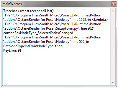

Whenever I try to "Disconnect" the "Bump" node, I get the following error message:
