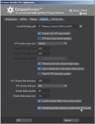

The next build has an option to disable the pass files save functions while rendering in F9.
