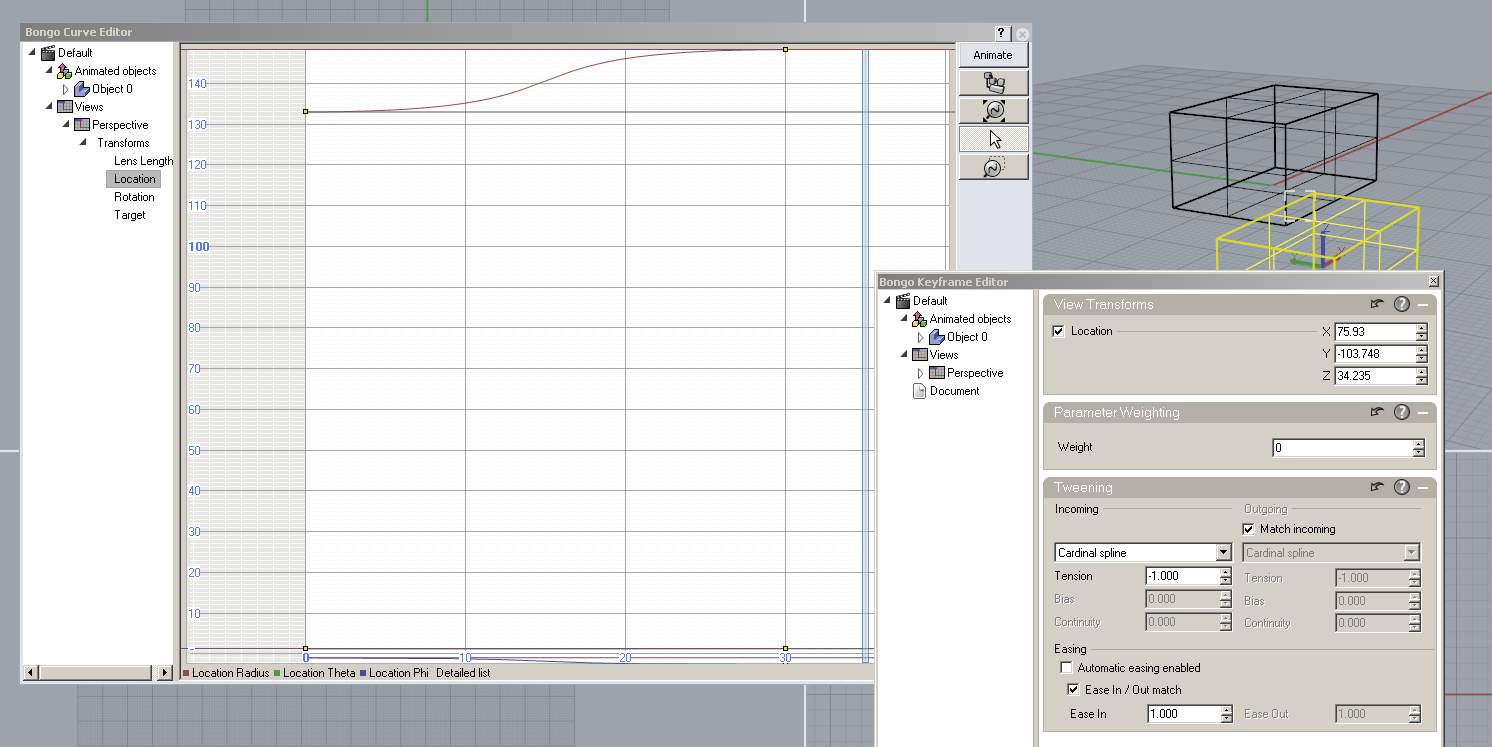

In Bongo I can set how a movement is done, for example a movement starts slowly than running fast and at the end the speed comes down. This is controlled by the Bongo curve editor, the movement can be looking smooth started and stoped. So, this info is transferred to OCS?

The Octane plugin exports each live mesh each frame according to it's position defined in Rhino (which is controlled by Bongo). So whatever the mesh positions are in the Rhino preview window will be the position exported to the OCS/ORBX file.In Bongo I can set how a movement is done, for example a movement starts slowly than running fast and at the end the speed comes down. This is controlled by the Bongo curve editor, the movement can be looking smooth started and stoped. So, this info is transferred to OCS?
