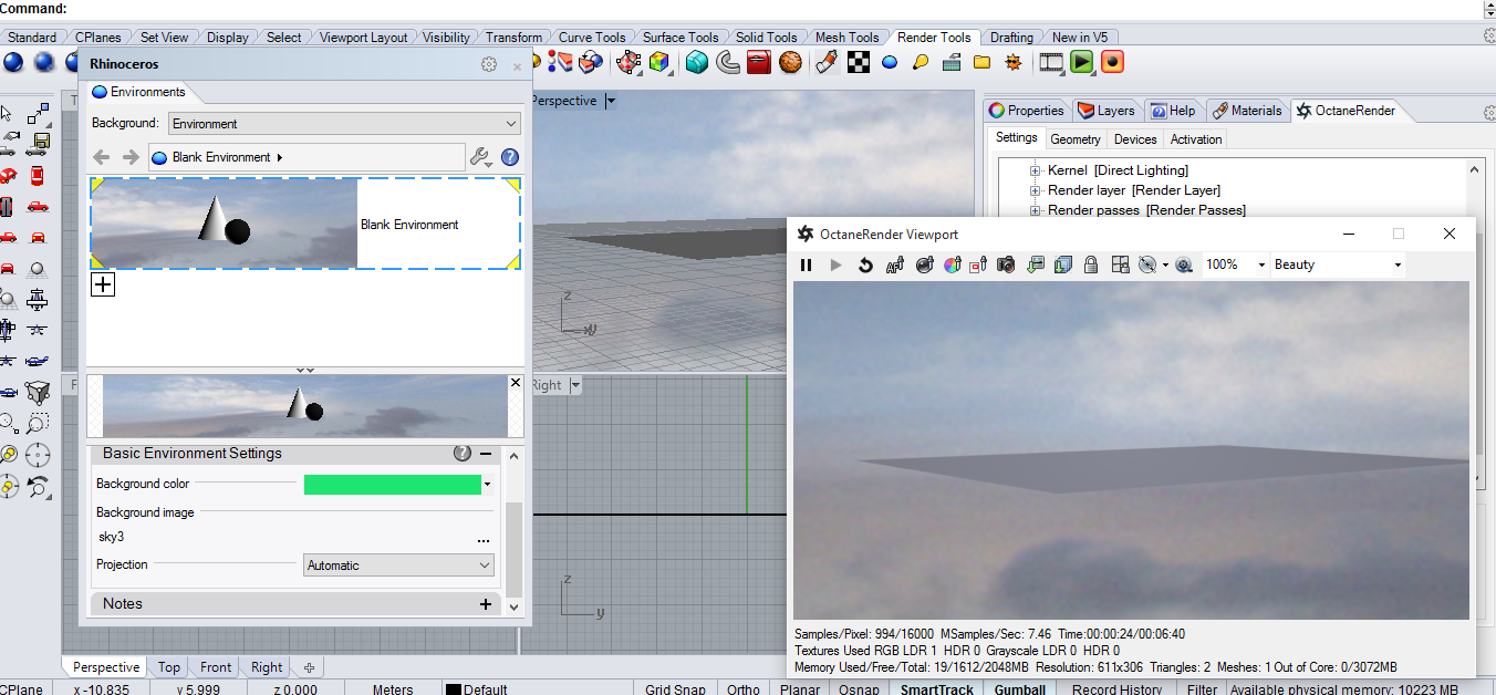

A test of the Rhino env shows me, that Rhino is updating the viewport, if the HDRI at the disk is changed. Great, the first step is done. But if I enable "Sync Octane Enviro to Rhino Enviro" then Octane doesn't follow the changes of the Rhino env. Attached a screenshot. Could this be fixed please?
Win7 64 | Dual Xeon E5-2687W | GTX 1080ti 11GB + GTX 780 6GB | Rhino3D
face_off
Posts: 15799
Location: Adelaide, Australia
I don't have VRay for Rhino - so cannot exactly match your workflow. However for me it appears to be working correctly. For example, set the Octane Environment to Texture Environment with a Texture = RGB Image and tick "Sync Octane Enviro to Rhino Enviro". Then assign different Rhino Environment Background Images and Octane picks up the new image automatically. I did have to set the Octane Environment Texture Spherical Project Y Rotation to 90 to get an exact match (but I don't think that's needed if using HDR Light Studio). See image below. I wonder if VRay is updating the Rhino environment in a way which is causing the "Update Environment" event to not be triggered....
