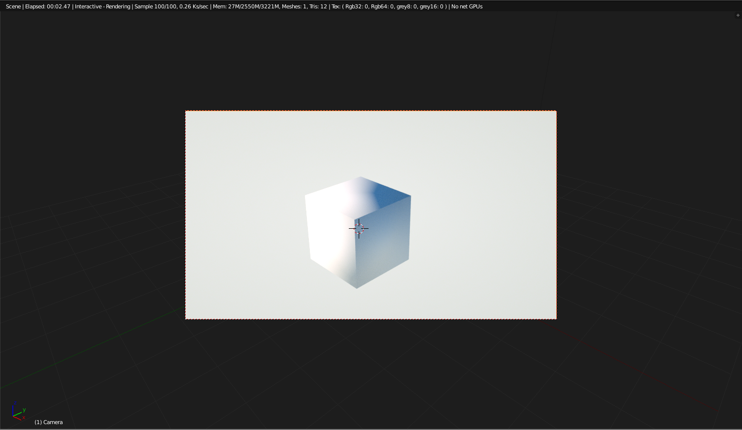

I followed your instructions but when I try to activate my licences on Blender the Octane Server shutdown and the render cannot be done. I launched the server again, then Blender, I checked on my Octane account and my licences are correctly activated, but I still don't have GPUs when rendering a scene.

Judging by the third image you seem to be rendering okay?
Fourth image it shows you trying to select your GPUs via Blender's user preferences but OctaneBleder is different. You select your GPUs from the Render panel. Fourth image shows one GPU is selected, so select the next box as well.
