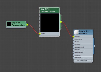

How to connect RGBTexture to GradientTexture like in Cinema4d? In 3dsMax in not working.
KeyTexture is missing in Max.

what the .. there are no options such as the ones you have in c4d :\
- c4d plugin devs are two levels ahead of 3ds max ones - this is disappointing - also you cannot use 3ds max procedural or any texture - just the octane ones ..
- seems like c4d plugin developers got pretty creative with the developing - and that I like -
this is how you connect a random to a gradient - your's looks like you used the 3d max gradient node which will not work
