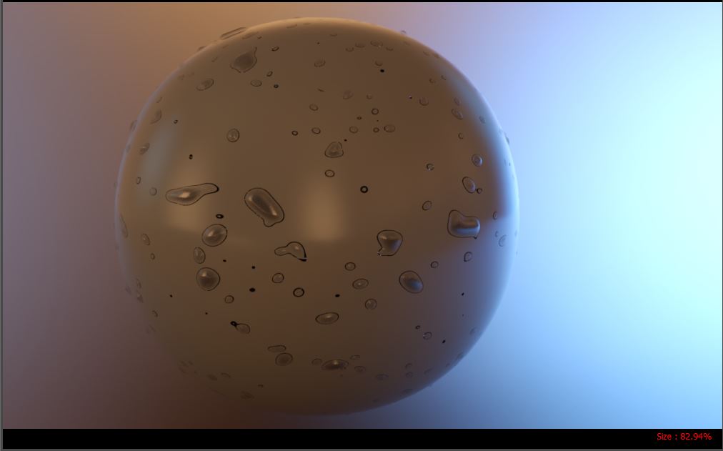

What's going on with these dark water drops?
itsallgoode9
Posts: 897
Joined: Thu Apr 03, 2014 9:04 am
Location: New York City
those drops were from an normal map online that i converted to a displacement map.
I'm testing a scattering program so I can have more flexibility in the density/randomness of the condensation, so here's a test using 1/2 spheres that slightly penetrate the surface of the can and i'm still getting some weird darkening happening.
the drops facing the camera are especially showing a weird dark shadow around the edge of each drop. The drop at the edges of the can aren't as big of offenders but the drops facing at the camera, where there's not directional light hitting them are really showing some unnatural looking shadows around the edges. It's making them look almost like flat circles.
I have pretty standard settings on everything:
Path trace
Spec depth=64 (i put that at a high value to make 100% make sure it had enough bounces to clear up)
Diffuse depth=8
Caustic blur=0 (i tested larger values but it didn't help the shadowing, it just make the drops less contrasty)
Alpha Shadow turned on
everything else is default.
standard water spec material

can somebody from octane please tell me what the situation is regarding this?
is something broken, or am I doing something wrong? this is starting to affect my deadlines and the lack of a straight answer from octane is getting very frustrating.

Tried what your doing and Im getting even stranger results.
I have two meshes in play here:
1 Base mesh with glossy material
1 Water mesh with displacement map and alpha channel applied to knockout the rest of mesh.. When I make the water mesh the exact size or smaller than the base mesh I get some weird interference.
What is going on here? This is really frustrating.
