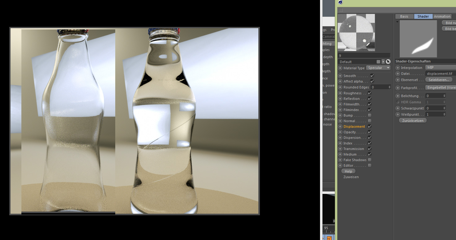

Hi there,
shouldn´t 50% grey remain "flat" within displacement?!
i need a stripe around a bottle and i only want to pull out the stripe but the displacement just works over the whole mesh (what mess up the glas) even everything else is 50% grey =/
did i miss something?!
greez
armin
Displacement 50% Grey
- gordonrobb
- Posts: 1247
- Joined: Sat Mar 16, 2013 9:08 am
Displace my in Octane has 0 displacement as Black. Either tweak your image, or use the 'shift' parameter, set to minus a half of the displacement amount. But beware, it often causes tearing.
