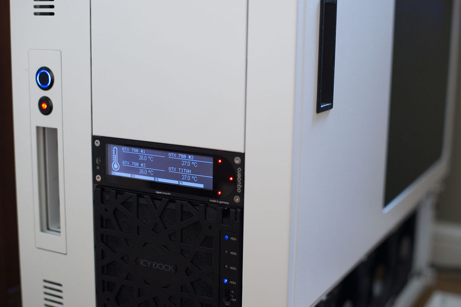

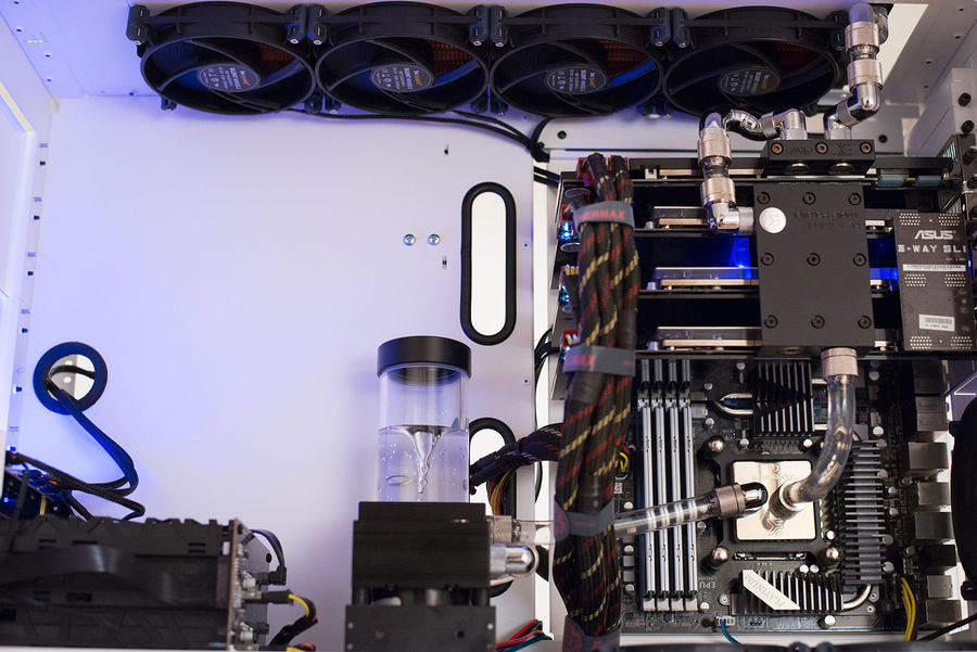

In the mean time, I was wondering how you got your aquaero to read all your graphic cards temp?
Also, having a vertex in your reservoir, is it a good thing?

As for temp readings - in the manual there is a list of 3 software that export readings - I think (don't remember exactly) I am using openhardwaremonitor.
Let me know if you manage to get it working

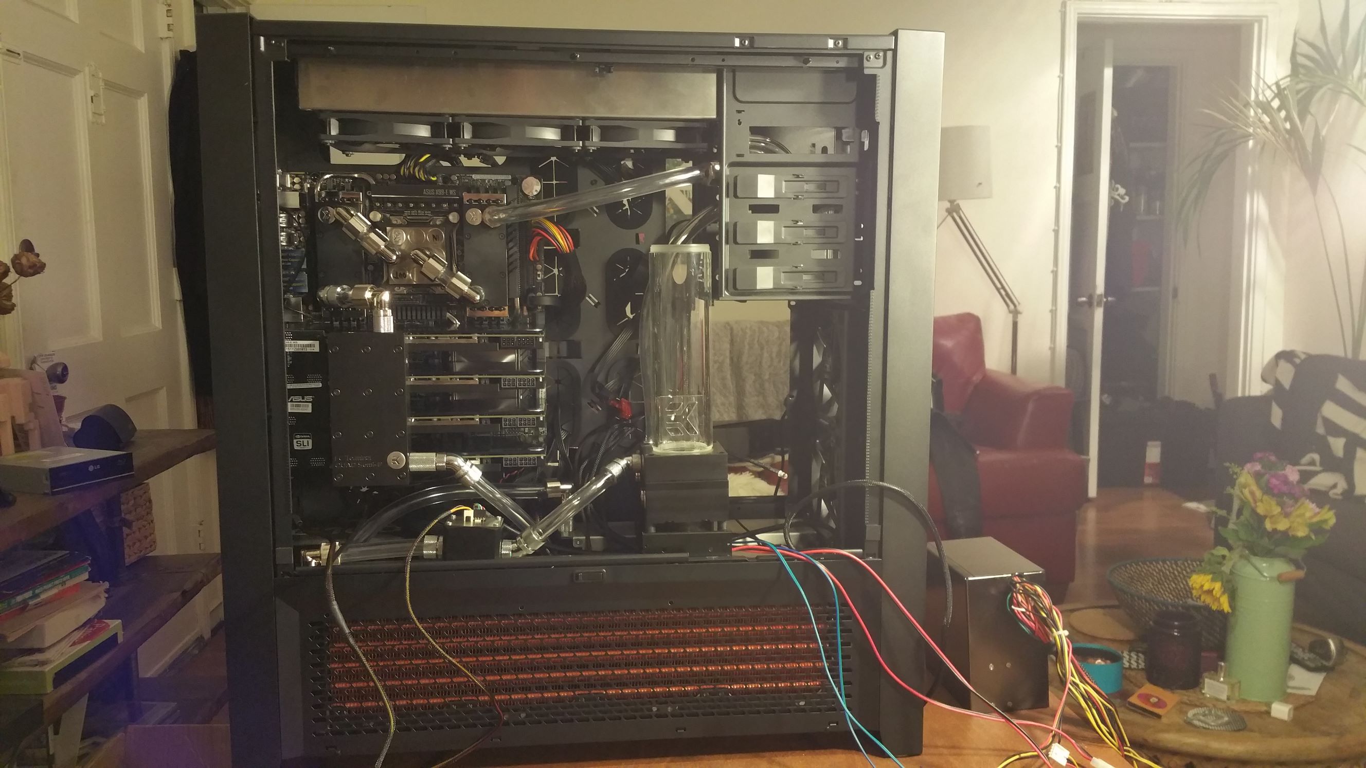

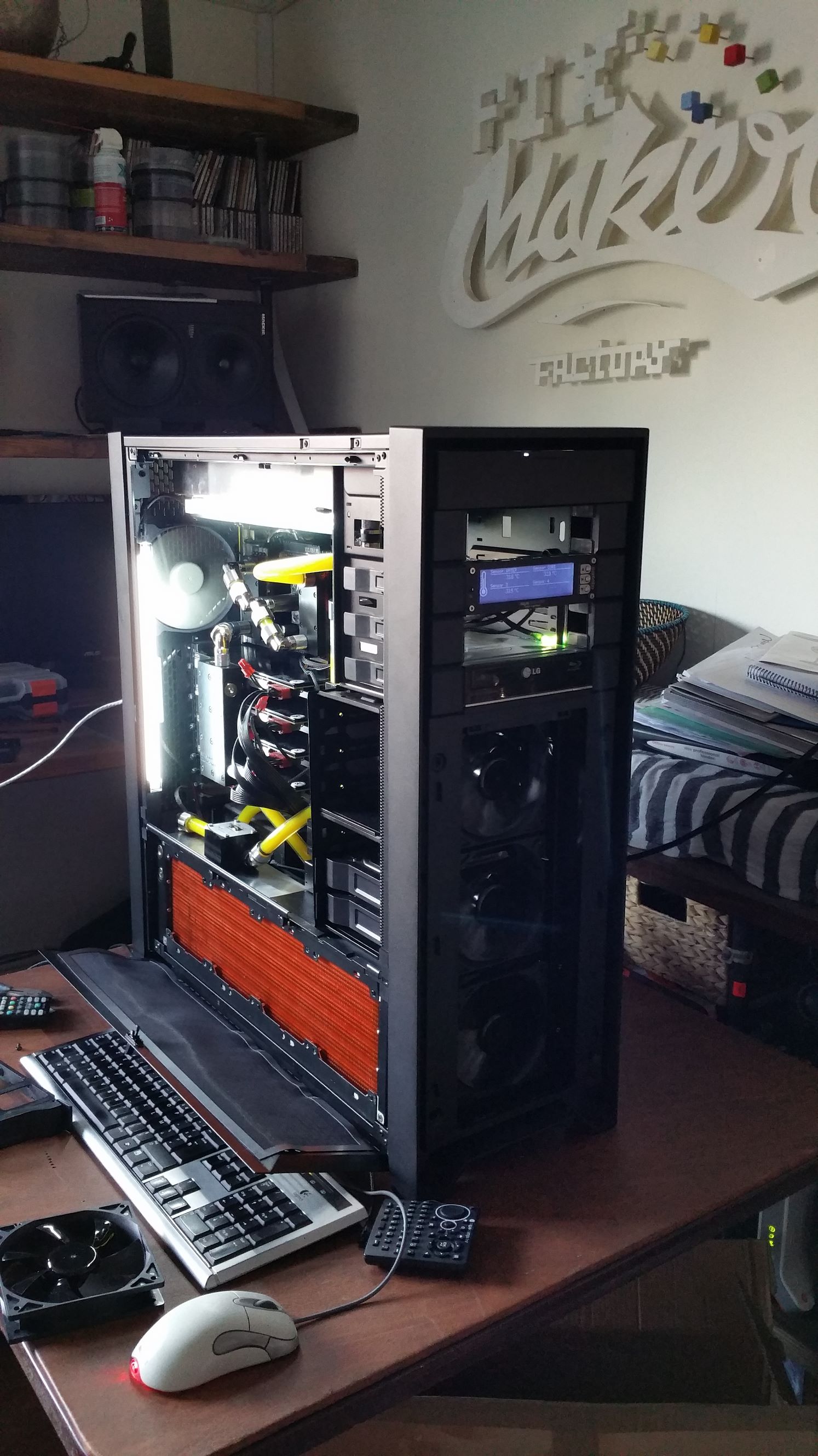

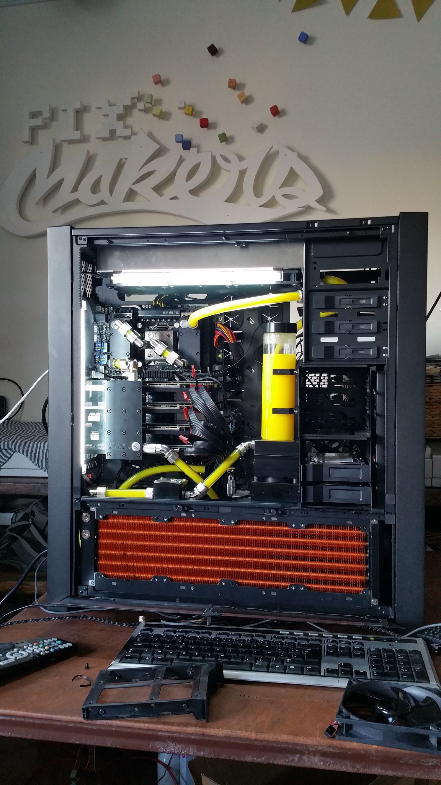

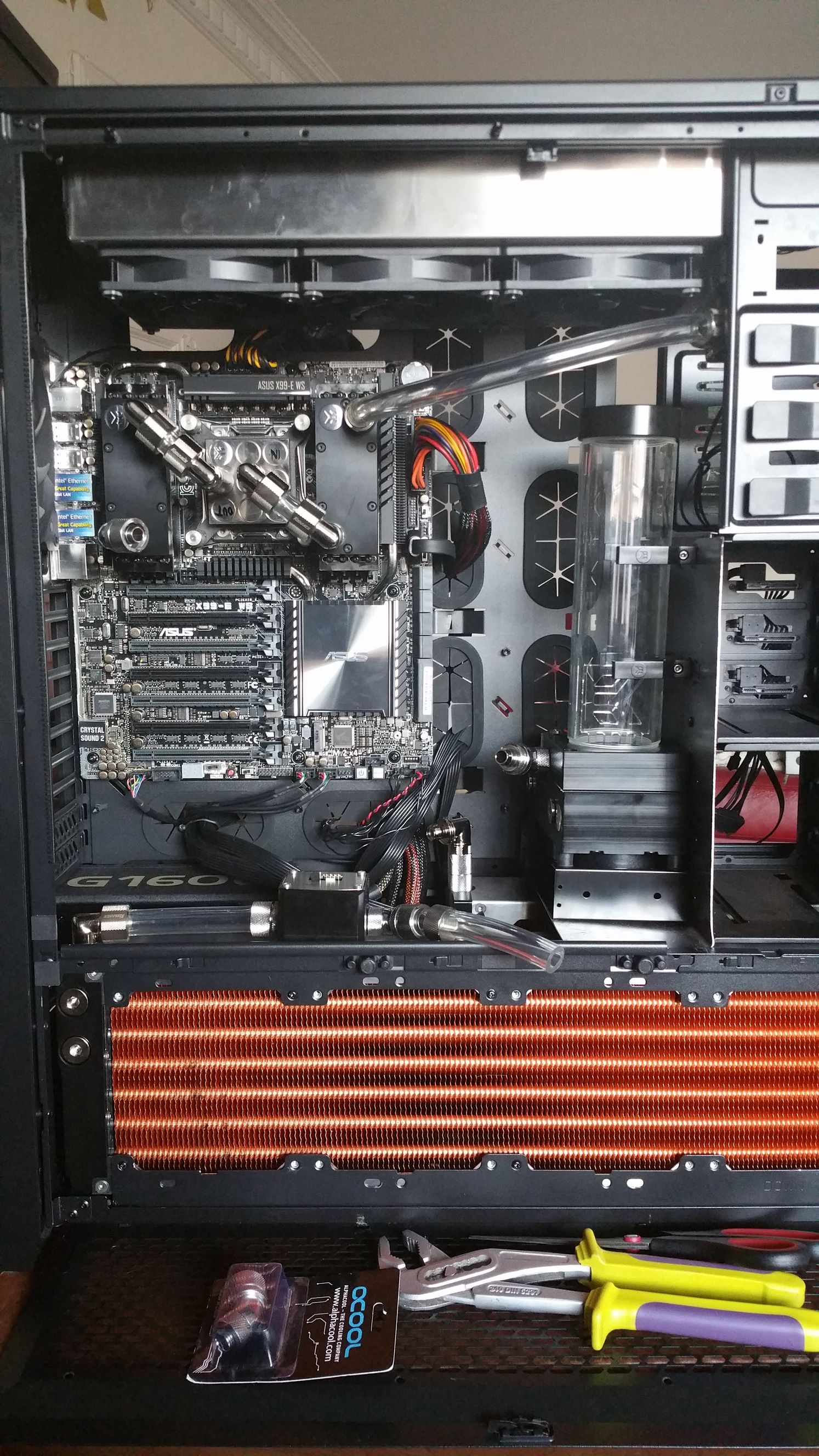

Here the beast, done, working!
Finally.
I still have to work on the connection with the aquaero + flow meter + mobo.
But in the mean time, I need to work as I did let the computer not running for the last 3 weeks..!
Win 8.1 64 | Geforce GTX780 x 4 | i7 5960X | 64GB
smicha
Posts: 3151
Location: Warsaw, Poland
Nice to see progress. Now you see how small for WC 900D is :)
Some remarks - I'd put the lepa fan on the other side to avoid hot air blowing from the longer radiator.
If I am not mistaken the fans on the lower 480 shall be in pull (air shall come into the case through the dust filter). It's a pity you don't have enough room for push pull in the lower chamber.
Curious about your temps.
Good luck!

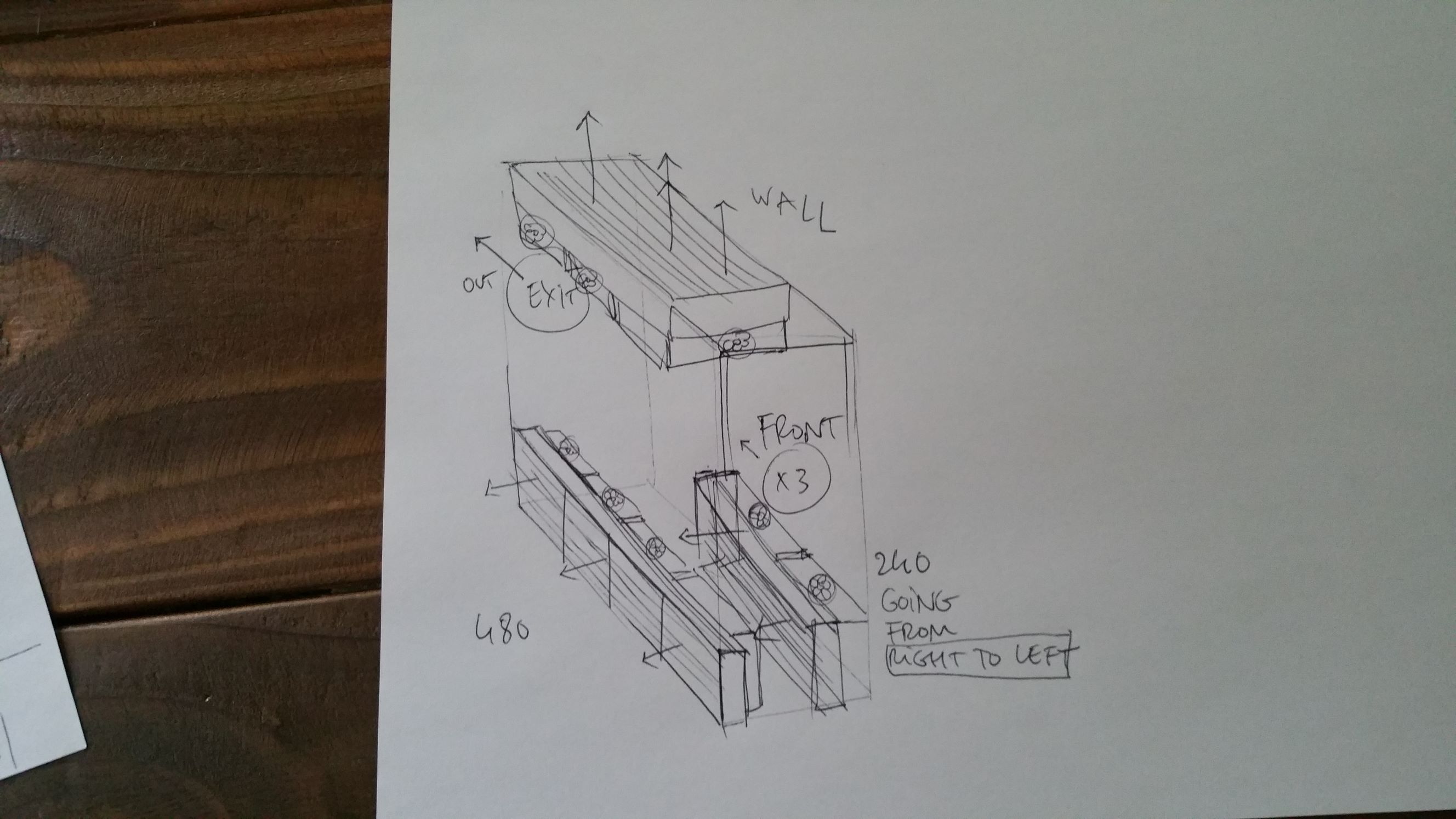

So, from what I understood, I did the best with what I tough would be good regarding the airflow, push or pull orientation of the fans.
Here is the actual system
If I'm not mistaken, you are telling me that, in the lower chamber, I should be pushing air from outside the case, trough the radiators, on both 480 and 240, right? So all the hot air would then be created from the bottom (with 480 pushing air against 240), then the hot air would come up inside the tower, then would be distributed to the exaust fan at the top rear, and the 360's fan top, right?

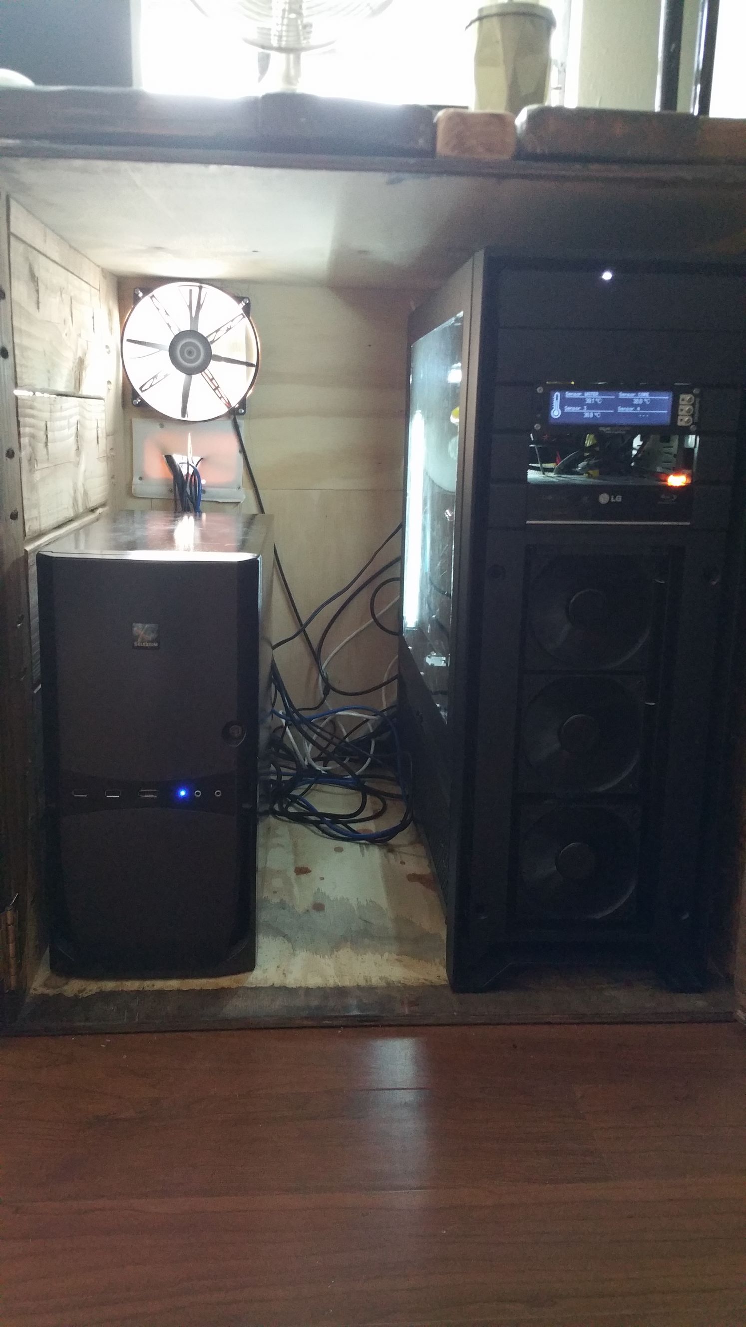

For now, the tower 900D is located in a box that is also exausting the air coming from the computer to the outside. Fresh air depends on the temperature of the room which varies is I turn the AC on.
Let me know what you think I should revise.
smicha
Posts: 3151
http://render.otoy.com/forum/viewtopic. ... 1&start=60
But if you want to put extra 240 at the back - no room for push pull.
