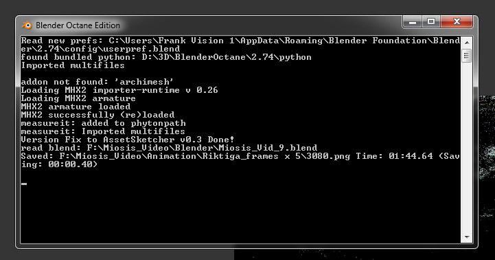

I think I found a bug... This one turned my hair grey until I figured it out.
I have a pretty long animation (15240 frames) containing a Make Human mesh and an Blender Ocean mesh. I am using a frame stepping of 5 and using frame blending in post in order to save render time. So far everything is fine. I then wanted to render out 5 images evenly distributed over the whole animation, so I enter a frame stepping of 3080. Now only the first frame renders, and then it stops. Not only that, if I do pretty much anything at this point Blender crashes.
I´m not sure this is as simple as only being the frame stepping though. I could remove the make human mesh and the ocean mesh, and then it would work.
If the frame stepping is the single issue here it should be simple to reproduce.
Jim, if you are taking a look at this and you can´t reproduce the problem I can send you the file in question.

Same error, but no report of mesh issues
Make human mesh issues

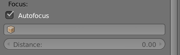

Is anyone able to render from a camera which is using a follow path constraint? when I switch to such a camera i get only black renders. Switch to an unconstrained camera and all is ok again.
The scene, and also a simple test scene with just camera/sphere/path will render in the viewport, but if you switch the viewport to the path constrained camera view (ie - numpad 0) it will go black. If you rotate or zoom the view it will stay black. Curiously, if you select and recentre a piece of geometry the viewport will render the scene as normal again.

jandress wrote:Is anyone able to render from a camera which is using a follow path constraint? when I switch to such a camera i get only black renders. Switch to an unconstrained camera and all is ok again.

Turning on auto focus allows the viewport to render camera and user perspective views properly, but if I render animation frames, I just get transparent (or black if no alpha).

jandress wrote:Turning on auto focus allows the viewport to render camera and user perspective views properly, but if I render animation frames, I just get transparent (or black if no alpha).
I've just shown you the way to look at, I didn't say to turn the autofocus on. If your autofocus point points into the infinity - it makes no sense for Octane camera. The same as "0.00" as the focus distance of real-world camera in manual mode. This was discussed here already many times...
Just play with these three settings you see on the screenshot and choose the one is appropriate for your scene.

Something was messed up in the blend file. I grouped everything and appended into a new file and everything works as expected.
