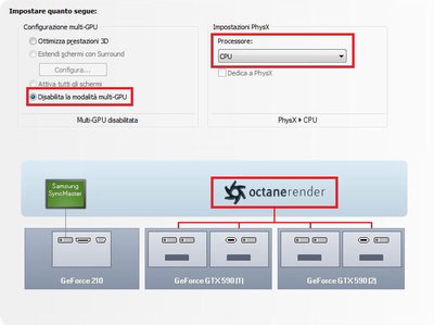

hi Hüseyin,
maybe it's not your case, but have you disable the "Multy-GPU" option in Nvidia control panel?
If enabled, sometimes it gives some troubles with the correct usage of VRAM
The best setup for Octane is always to have a dedicated GPU for displays only, in this way the VRAM dedicated to Octane is not reduced by the system and display
ciao beppe p.s. Sorry for the italian screenshot
