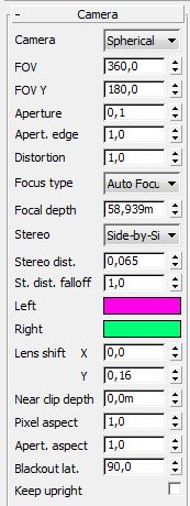

hi
i received my headset today. nice quality!
i wonder what is the best render size for a 3d stereoscopic side by side image?
(i see goldorak use 1136px x 640px - but that seems to be to small for 3d images)
i have tried 3000x1500, and it works ok, but i wonder if there is a optimal size, so it's not overdone, and not to grainy.
i need to make adjustment in mobile vr station some settings to get shaper images when using the headset, but the settings are a jungle :-/
but all in all, it gives a very nice feeling of the space - and i'm going to show it to the invester next week
ps. i'm using a iphone 5s.
pps. i have attached the camera settings
thanks
jorgensen
